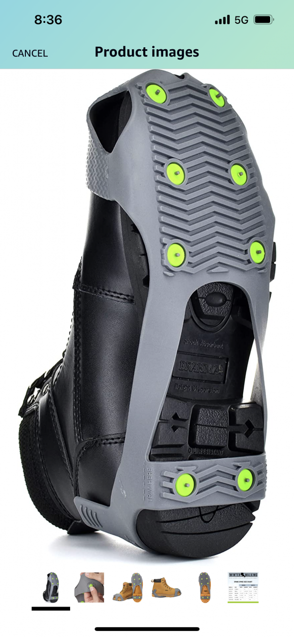

    Walk across the parking lot.
    Jog across it.
    Run full steam.
    If any of following happens, or while getting out of truck it’s to bad.
    BAF8D784-404E-421B-8988-3DE1F57B2420.jpeg 22A20D97-8B5D-4D36-925F-F8FACE9EF451.png 5CB63808-F57F-4625-BC14-DB4157282257.jpeg
