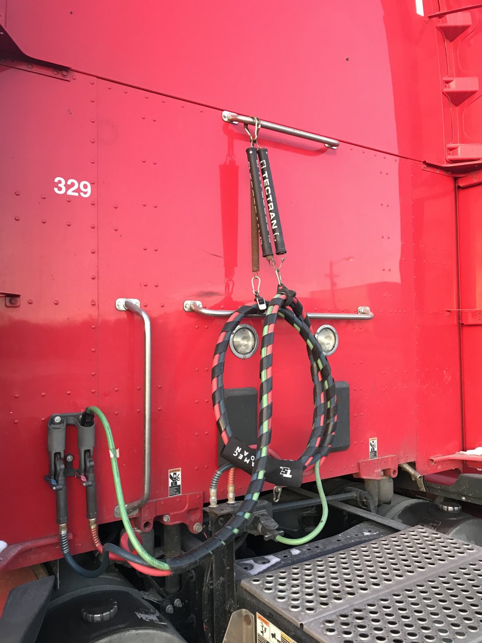

  3. scoobertdoo
    scoobertdoo Road Train Member
    1,512
    2,603
    Nov 11, 2020
    I did, but its still touching, I'll need a second hanger.
    I had to get this lineset. I broke 3 of the plastic ones last winter in -10 weather.
    JoeyJunk, Siinman, D.Tibbitt and 2 others Thank this.

  6. D.Tibbitt
    22,087
    151,679
    For a temporary fix, just source a bungee strap and feed 1 hook thru the black wrap and hook the other side to the grab handle thats up top on back of the cab. Should be able to atleast get it off the catwalk for now

  7. Dino soar
    Dino soar Road Train Member
    4,791
    26,884
    Dec 8, 2017
    Do as you wish but really you should just find a way to hang it.
    Eventually it's just going to wear through anyway, or you may have a problem with some officer somewhere, so the easiest thing would just be to make it hang whatever you do.

  8. Rideandrepair
    17,358
    56,320
    Aug 8, 2015
    Two hangers, and maybe even a short spring between the two, keeping it away from the unit. If I were a DOT Officer. I’d write a ticket. Merry Christmas!! Lol. I see a lot of lines laying on catwalks. I wonder how they get away with it. Used to be a big red flag.

  10. HoneyBadger67
    HoneyBadger67 Road Train Member
    2,056
    4,512
    Dec 15, 2018
    Savannah, TN
    You've got the extra slider bar up high, use it. Just get the spring type pigtail holder.
