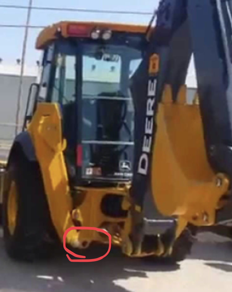

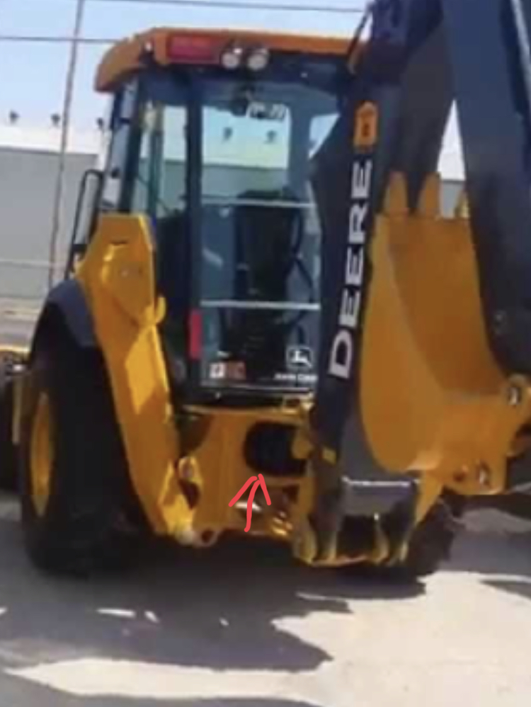

  10. johndeere4020
    8,522
    119,296
    Jan 1, 2010
    Depends on how “close” to the edge, if they’re in a foot or more I don’t cross chain. The steeper angle shorter chain is stronger and more stable. Also chaining higher is better IMO. A backhoe for example this is the factory securement point
    But I use my 1/2” slip hooks and hook here
    It pulls down more giving better securement against tipping.
    SAR, MACK E-6, PoleCrusher and 3 others Thank this.
