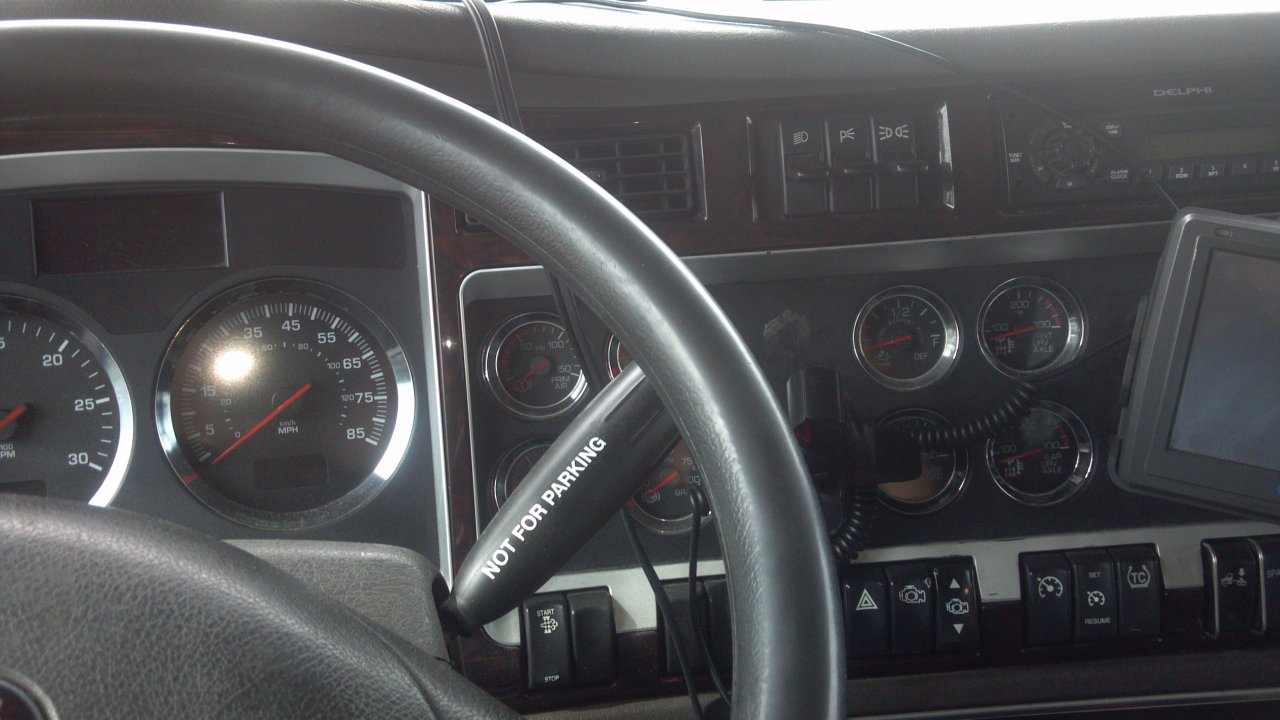

    Anyone with kw T660 could tell me where theres supposed to be fog light switch on this truck?
    Company ordered truck without them installed but theres wiring running up to where fog light supposed to be and no switch on the dash.
    Is there typically switch right off of engine fan switch? Theres blank insert there right now.

    Man, what interior do you have? I may be wrong, but I believe they only put switch when lights are on them from factory. It's probably supposed to be one of the blanks on the right.

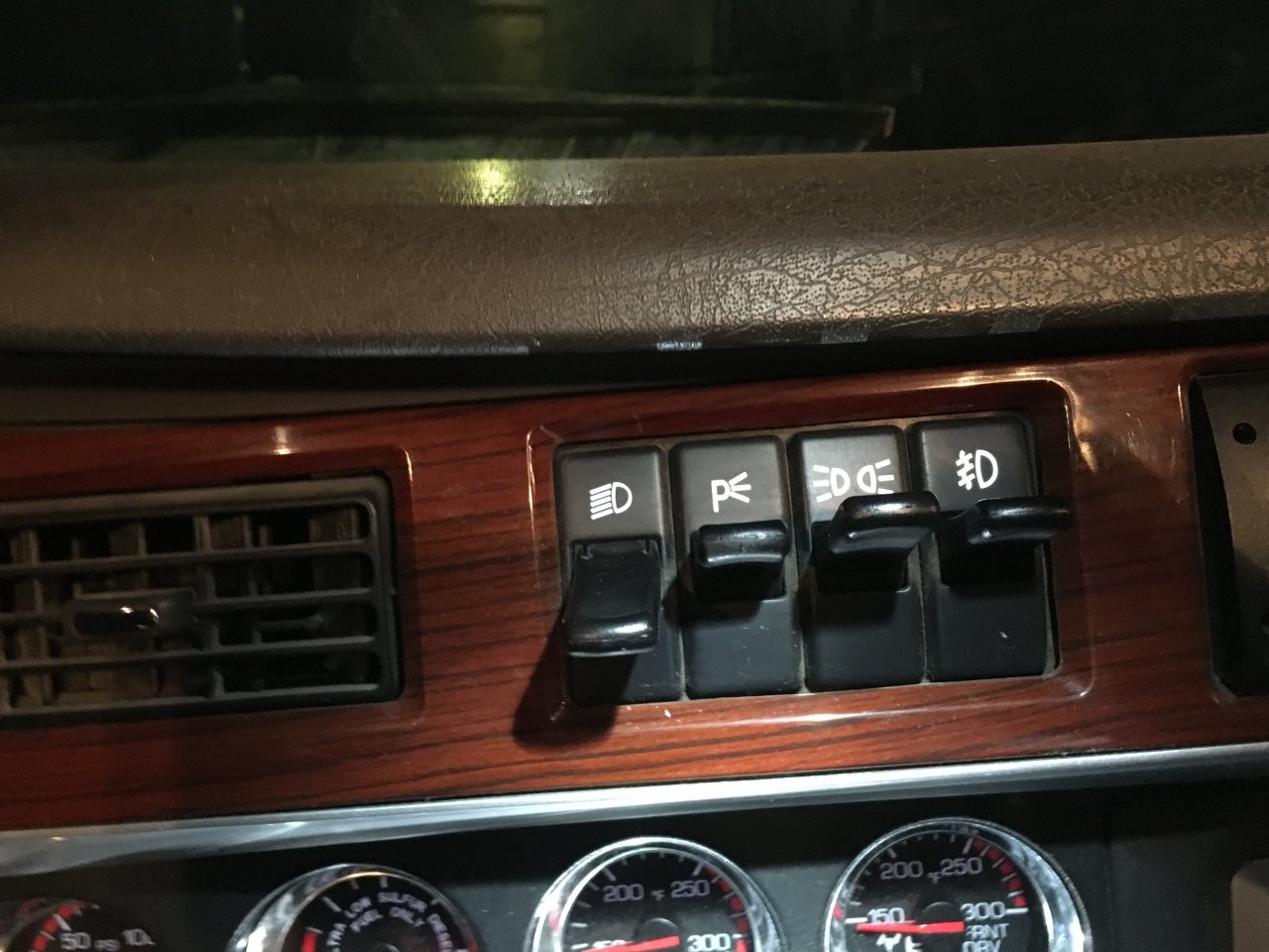

    Not sure on 660 but my 800 it's beside the headlight and parking lights switch near the radio.......

    Another pic of dash. Looks like theres no provision for fog light switch but they ran wiring for fogs under the hood.

    Between the radio and the ac vent there's 3 switches on your dash(should be 4) . Slide the 3 to the left and the switch for fog light goes next to the radio...

    Slide them? You mean this panel that holds these switches is adjustable?
    Do you think its prewired for fog light switch?

    Not sure but that spot is made to hold 4 switchs....
    If you look at yours there is some space on both outside switchs... with 4 there's no space..

    The factory wiring has wires for all sorts of switches prewired.
    Whether your truck was ordered with the switch that goes to them is another story.
    It's easier for the factory to use a standard loom and then add switches as ordered by customer.
