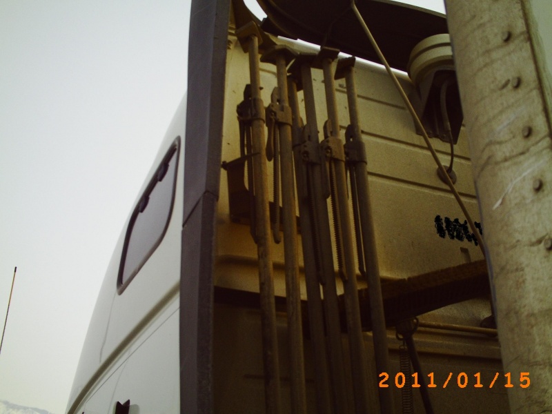

    Speaking of drops and hooks, sometimes you lose your load locks too. So try to carry extra ones. I can hold 6 on my load lock carrier by using a ratchet strap to secure them. This way if I need to lose 2 of them, I still have the minimum number of 4 required. Sometimes you'll be at a shipper that requires 2 load locks thrown in the trailer before you enter the gate and invariably there will be another Swifty in the line who did his arrive at shipper then decided to read the special instructions at that time finally, and starts begging on the CB if anyone has extra load locks lol. This way by carrying 6 you could potentially help 4 Swifties who needed just 1 or 2 Swifties who needed 2.
