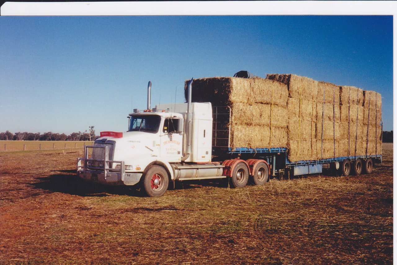

    Those 3176B's are a Great Little Motor..
    I had one back in the Day. Though Mine was set @ 365Hp & I had an 18speed.
    Definitely one of the Better Trucks I've owned over the years..

    Good looking rig! Also glad to hear you are a fan of the b models too. I know most CAT guys I talked to haven’t spoken highly of them but say the b models were far superior to the a models.
    Since you had some wheeltime with one let me ask you this, we’re you able to smoothly float the gears downshifting? I haven’t had much seat time in mine so maybe that’s what I’m feeling but it’s a little rough getting it out of gear at the shift point. Read elsewhere a lot of guys will double clutch downshifting on them. Did you do that?

    It's at least 22-3 yrs since I sold that Truck.! But from (foggy) Memory "Yes"
    CAT ECM's have (or at least did) a feature called Latch Control which meant that the Jacobs Brake would Work when you had your foot on the Brake pedal.. Lift your Foot NO Jake.
    This Feature makes it VERY easy to Float Downshifts... I still use the Clutch on Compound Shift though.. As It's a bit easier on the range change Syncro..
