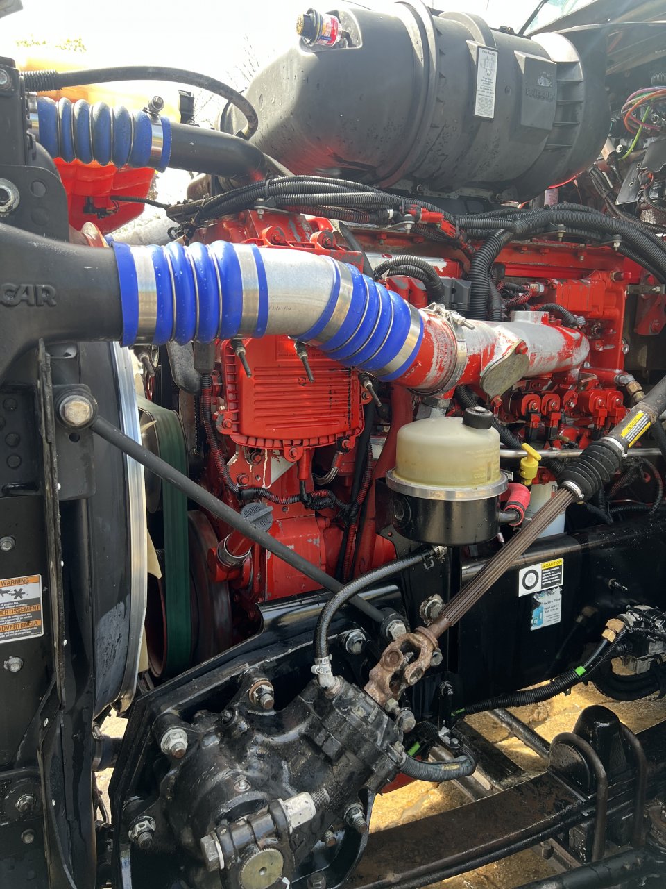

    That looks almost like new. Do you really drive that?

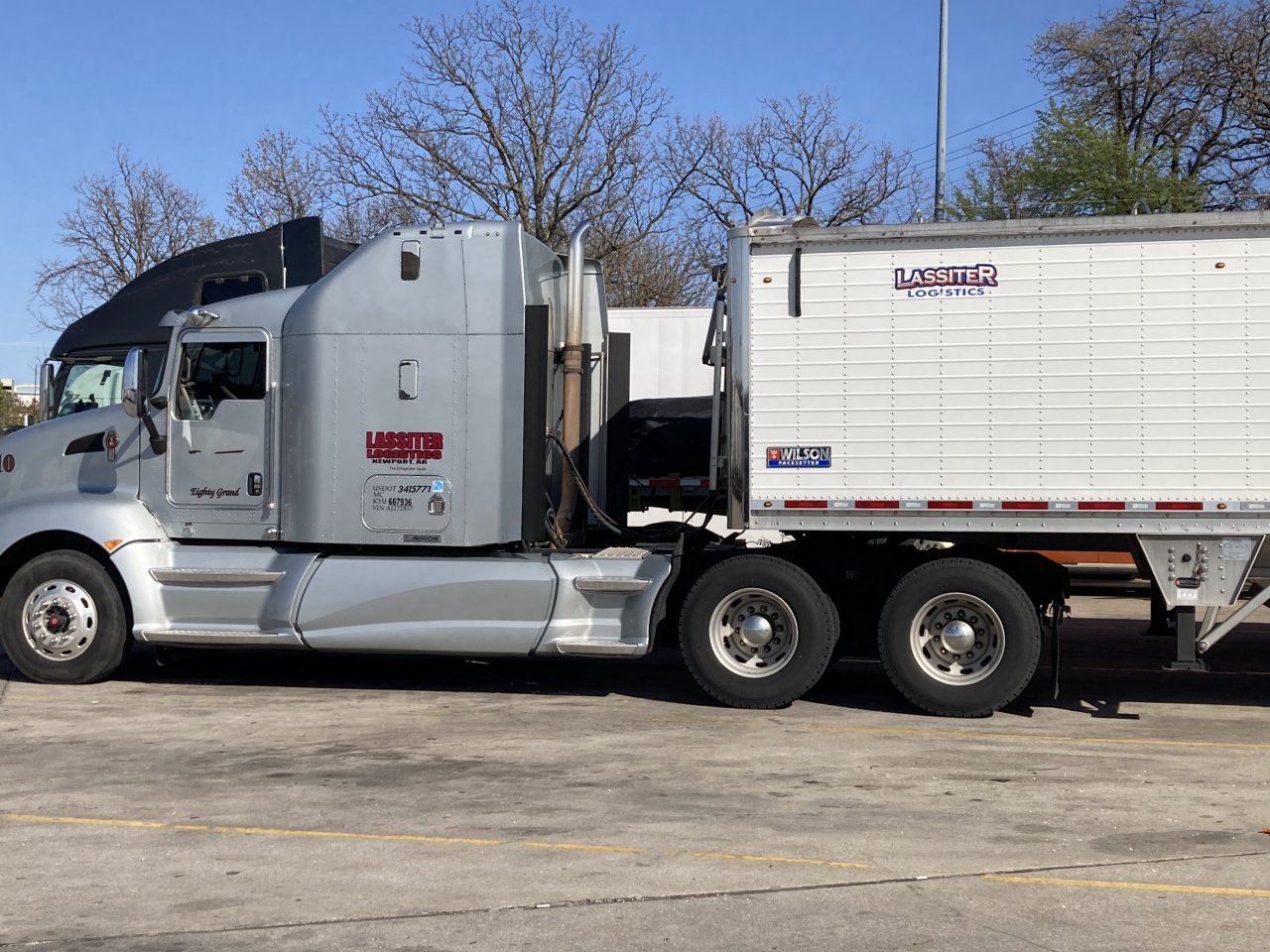

    Yep, in the ‘10 KW T660.
    Photo from last year, I’ve fixed the paint peel on the sleeper wing windows too.

    NICE !
