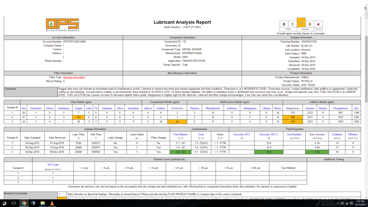

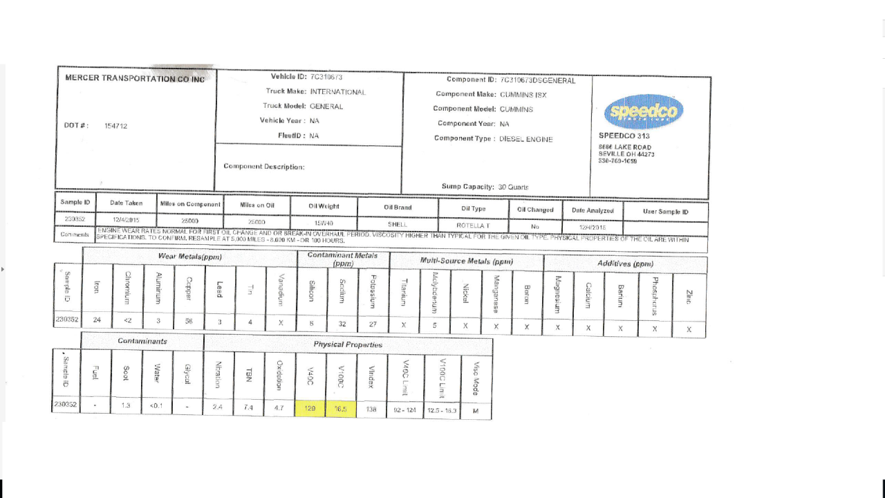

    So i wanted to compare oil sample's Both samples was taken at same time. One was done on site(Speed co). Other was sent to Polaris labs(OPS). oil sample.png oil sample1.png

    For one thing Speedco put the engine mileage down at 25000 instead of what actual mileage is, unless you had a complete overhaul, then it would be right. They were testing for materials as would be expected on a new engine during break in.

    Speedco puts the mileage on the oil, not the engine.

    Did you pull both samples at the same time?
    Never mind, just read your post again...
    Interesting.
  9. larry2903
    larry2903 Heavy Load Member
    789
    994
    Oct 18, 2009
    On the trails
    Did you use any additives in the oil sampled?

    Were those taken at the same time? I mean, I don't know much about how it should read, but that looks like a pretty big discrepancy in the potassium numbers. The rest looks fairly similar though.

    TBN is off pretty good to. That's the number that tells you when to change the oil. 7.4 to 3.9 is a sizable difference.
