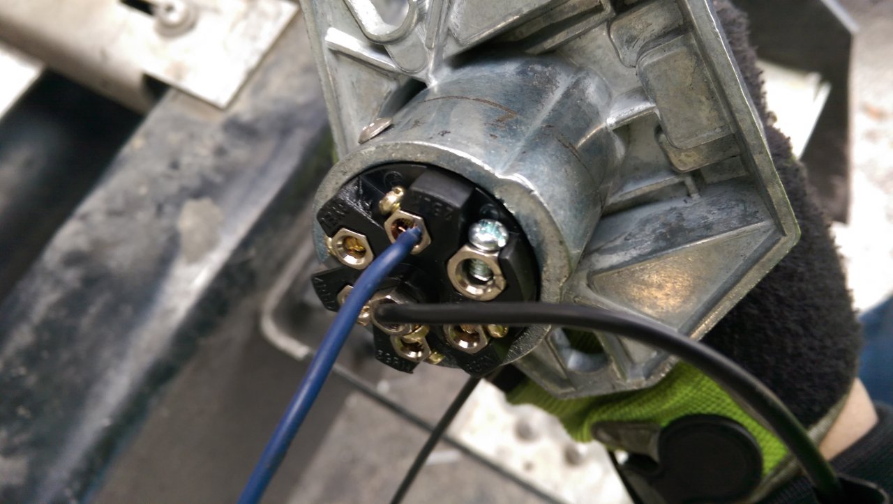

    Okay @spyder7723 told me how to run my dump switch. I have it running hot to toggle toggle to pigtail on truck. Ground going to batteries. I'm getting good ground good hot even to trailer with my power cord. But trailer won't dump air... Will it only work if it has weight? IMAG0218.jpg IMAG0218.jpg IMAG0216.jpg IMAG0217.jpg

    Hmm maybe it is working I hear like an air noise but the rear bags still got air lol

    Are you dumping the trucks air bags or trailers?
