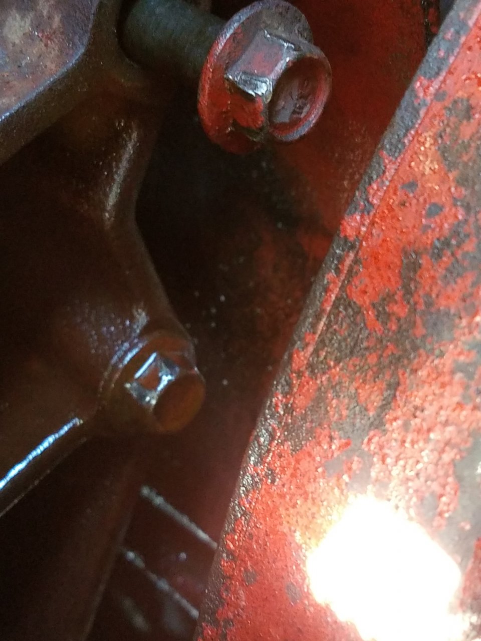

    Pete, when mine was replaced the housing the water pump bolts to was removed with the pump still bolted on. Its sealed to the block with o-rings and should be easier to unbolt than the pump alone.

    hmm might try that. Other wise the fan has to come off and the Balancers...Which is gonna suck.

    Use a 6 sided box wrench or socket . It will contact more flat area of the bolt than a 12 sided. Or vise grips. Did you try heating and cooling it and heating it?

    20161220_134024.jpg After 10 hours of trying to upload here it is.. The bottom bolt is whats giving me problems. As you can see not much room for work lol

    Well.. The balancer is off.. Ordered some new bolts..
