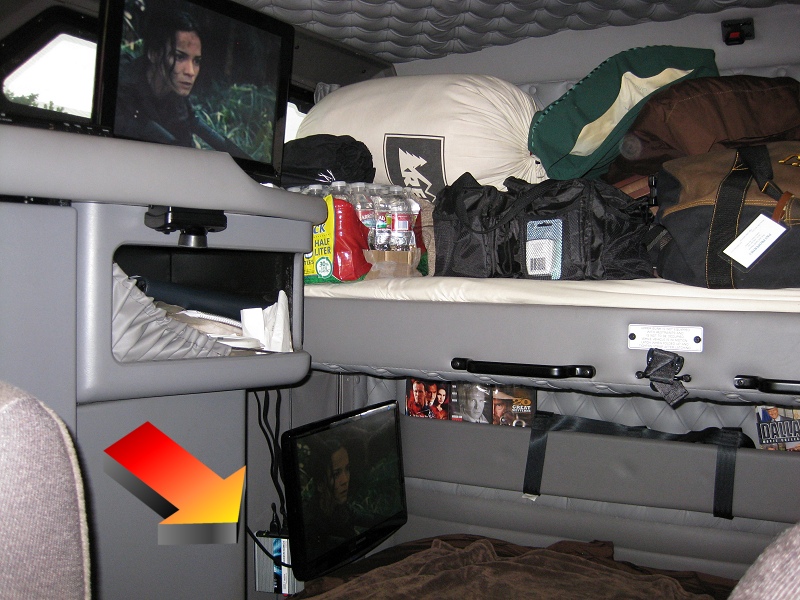

    Back to your TV question: modern LED TV's use DRAMATICALLY lower wattage than in the past. Plasmas use more though.
    Here's an example picture. This is a dual (upper bunk/lower bunk) install. I pointed an arrow at the 400 watt inverter we attached to the mount. That one small inverter was powering both TV's and the satellite box and was still using less than 250 watts COMBINED.

    Yah, this one had one DirecTV receiver, so both TV's had to be viewing the same channel. But yes, it was still pretty cool when we were done. I asked him if he had a wife or a Co-Driver or something. He said "No, just in case."
