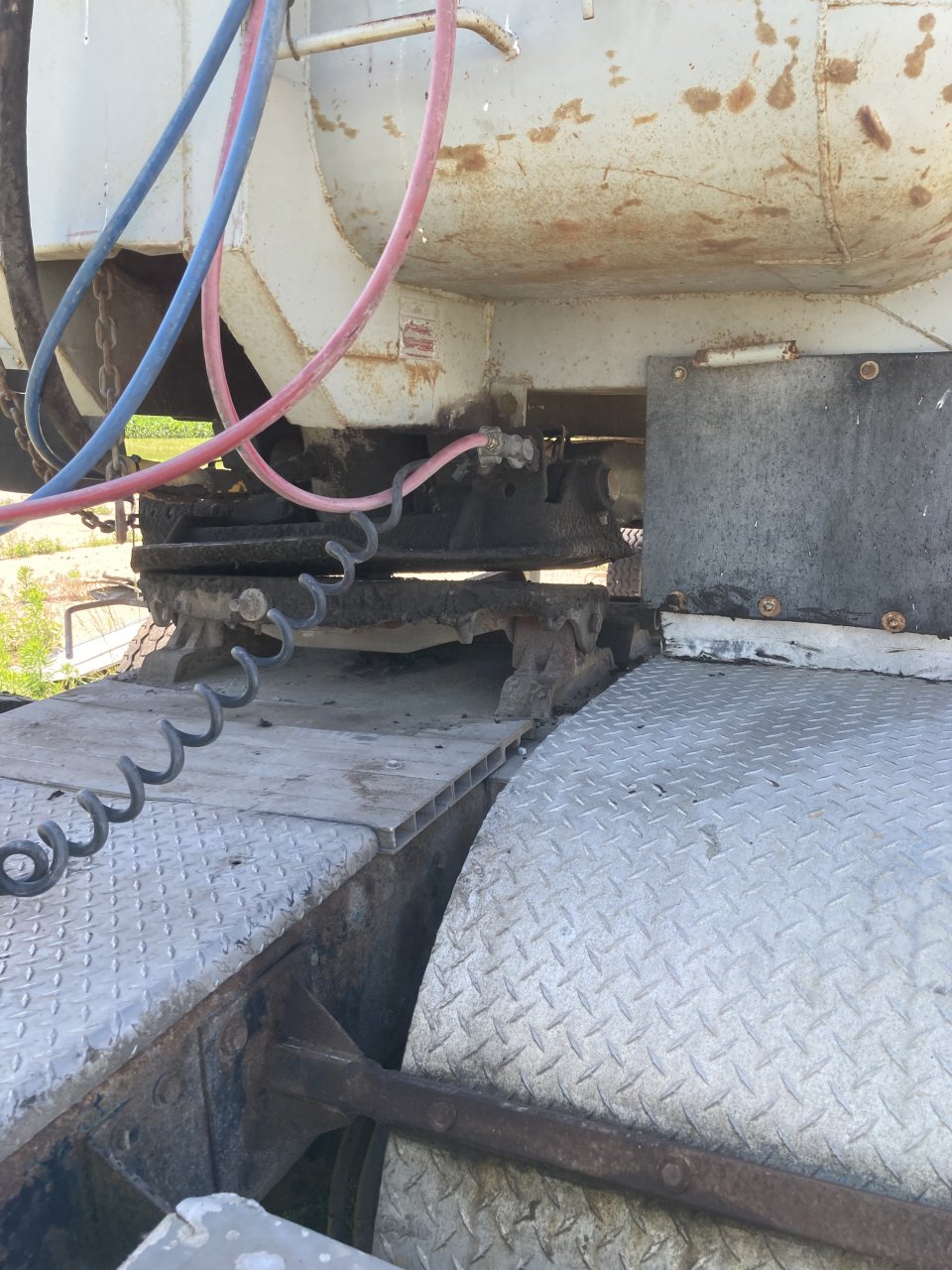

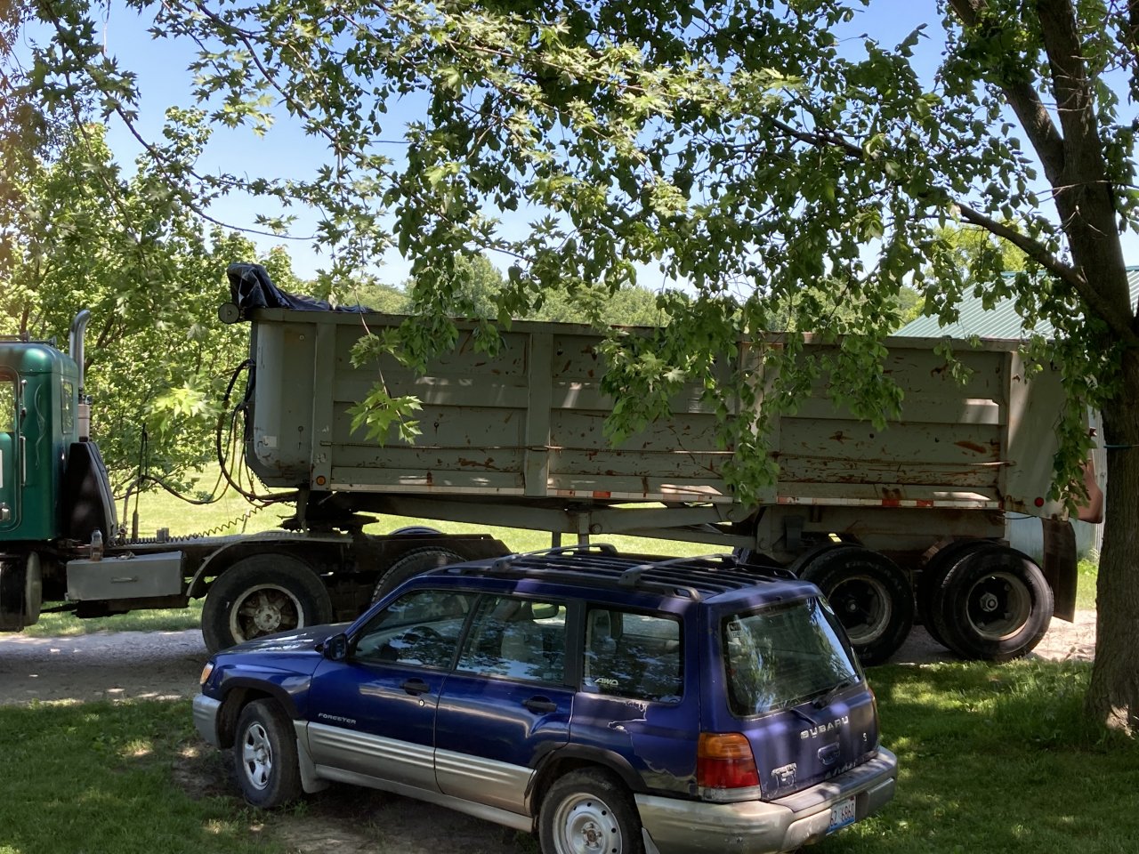

    Well it made it to my shop this morning.
    Pulled it down the road like nothing was wrong and disappeared on the backroads until the last 1/4 mile if highway to the shop. It took some enginuity to get it connected and those arms are a lot stiffer than I expected I had to run one axle lock and power divider because the left drive tires were barely on the ground
    5F4E0DA0-1B3B-48B1-89F4-516C987426EE.jpeg 58601EAC-A20B-4FC3-B33E-735E41AB8056.jpeg thanks for the advice everyone
