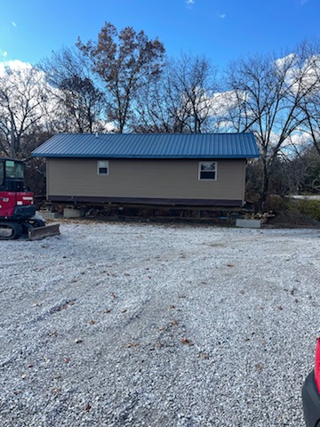

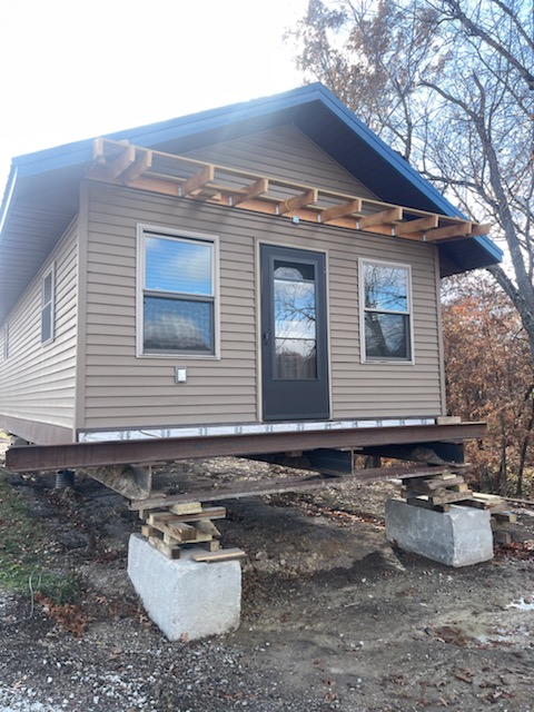

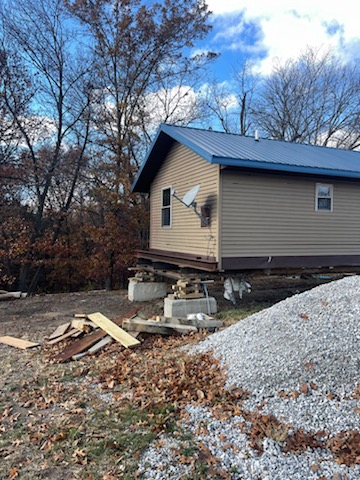

    so I had a friend approach me about moving this cabin. It would be a relatively easy 40 mile trip….mostly deserted interstate and only 1 over pass which I can get off and go over and back down to the road. As you can see it’s on this I beam raft deal. If we remove the center beam I can get down around 16’8” height. the structure is 16 foot wide and 19 at the eaves it’s 38’ long. He’s suggesting we back the trailer under it and support it with a combination of the i beam structure and my trailer which seems fine to me but how do I secure the actual house…. I Can chain the I beam deal down easily but it’s not really attached to the building. Any thoughts would be welcome I pretty much only have done machinery in the past

    Think the modular movers use a lot of bigger hardware to attach the main structure to the trailer frames they use/ big lags & such thru the flanges and rails of the trailer with attached framing lumber to the building
    Idk with a lowboy… unless you secured the point of attachment to the trailer and made #### sure the point of attachment was all solidly connected to the structure
    Worth asking someone that hauls modulars where the best point to attach are, relative to twisting during transport

    I hauled the new modular units without the trusses and roof, and we were just strapping, because it was a box. But you got the roof on.
    The specialized step decks had several extendable outriggers that they would send a lag bolt up through, and into the bottom plate. Pretty much what @Ruthless said. If you can drill through the I-beams and send lags into the bottom plate or joists of the building, that is basically how everyone else does it. And obviously chain the steel frame to your trailer.
    16' wide isn't a problem, it's the 19' at the eaves that the state might consider a super load. I'm guessing you'll doll up a couple of cars with some flags and banners to act as escorts? What state are you moving in, I'll have a Quick Look see. May have an exemption for modular housing.
    Have a good look at how it's been constructed underneath - it's only 40 miles, but you don't want to crack all his interior surfaces, bust tile etc if there's too much flex vs. the support you can give it.
