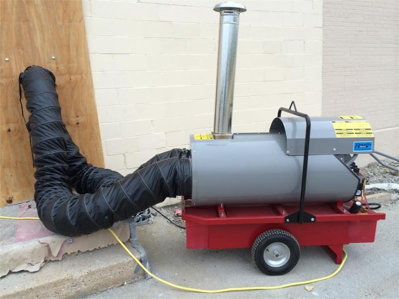

    Never seen one of those. Pretty neat.

    Essential when you live up in the cold. Its indirect fired, kinda acts like a furnace in way. All the fire goes into the chamber and exhausts out the stack. Fresh air blows past the exchanger and out the end. Pretty common on construction sites in winter, they'll use them to heat the building's interior once the walls and roof are up so they can run the utilities, do the drywall work etc despite it being 30 below outside.
