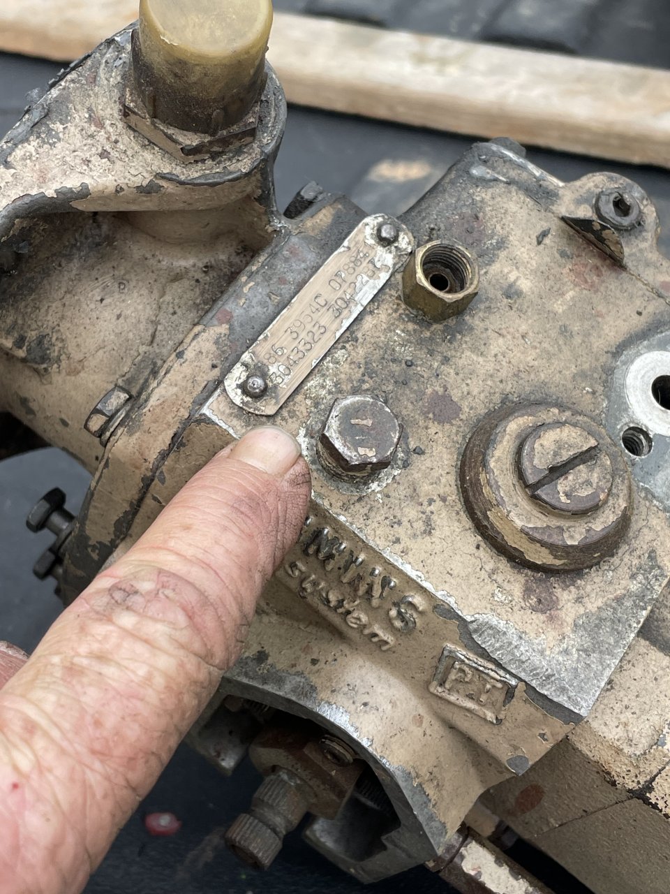

    Look on the left rear of the block below the rear head gasket, the serial number will be in the block there….
  5. OLDSKOOLERnWV
    18,255
    274,806
    The serial number will tell you what the engine started it’s life as….
    But, the tag on top the pump will have another set of numbers, this will tell you what the fuel code is on the pump, in other words it tells you what hp the pump is calibrated for. Hope this helps….

    I’ve seen pumps without a tag, and the fuel code is stamped into the housing where the tag should be….
