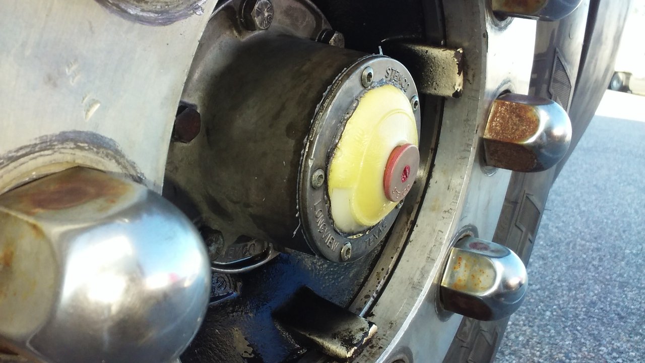

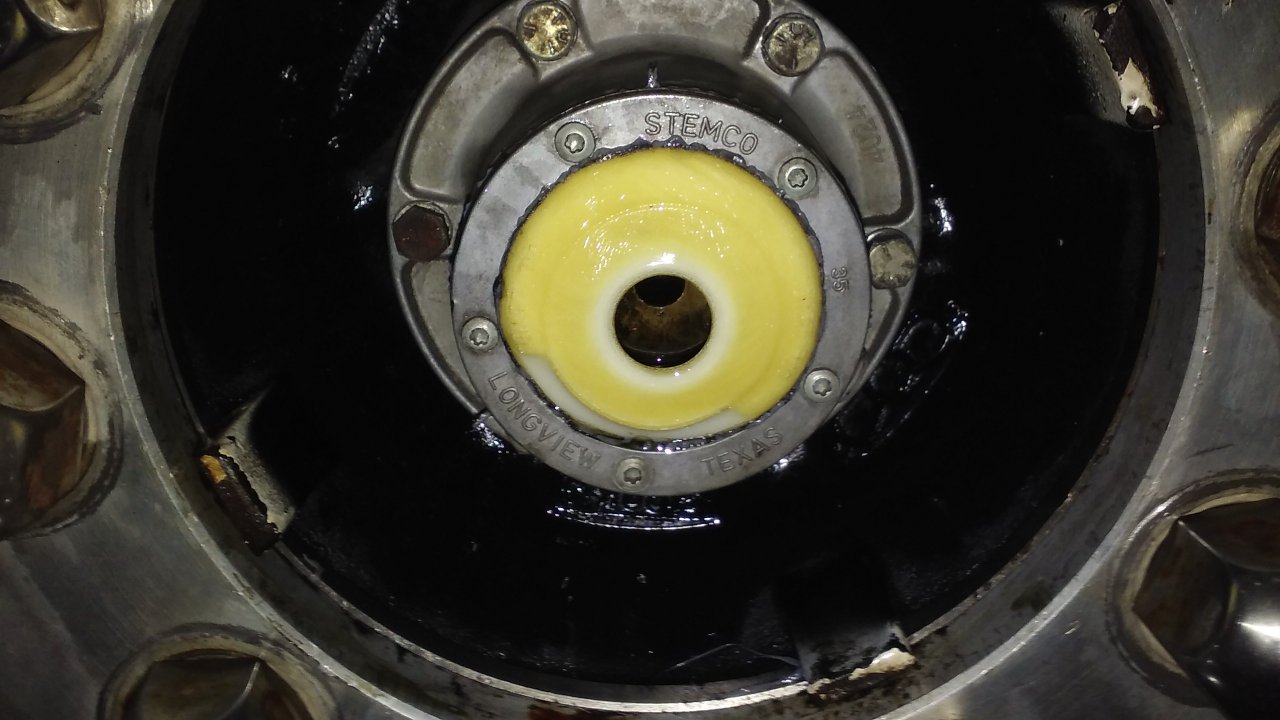

    Op did you take a pic of the melted sight glass.? I'd like to see that.! :eek:
    On my old truck I paid to have a leaky steer axle wheel seal replaced. They did a sheety job, & 80 miles down the road I stopped to check on it only to see this.. The glass was not convex, & clear 80 miles earlier.. :confused:
    When you get going stop soon & put your hand/temp gun on the hub to make sure she ain't burning up on you again..
