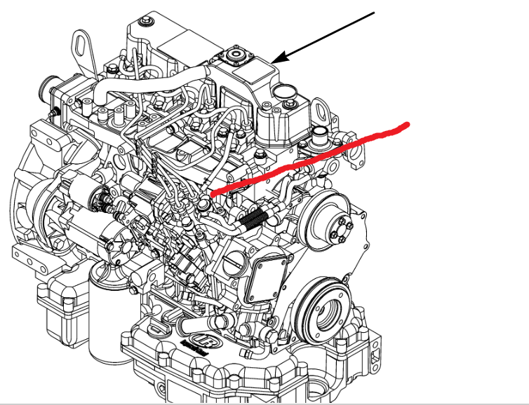

  9. Snailexpress
    2,675
    6,068
    Apr 28, 2014
    Rocky
    First of all what reefer do you have? Thermo King or Carrier. The plug is on high pressure fuel pump. Make it loose then unscrew priming pump and pump until fuel comes from under plug without air. Otherwise you can damage high pressure fuel pump running it dry. Pressurizing fuel tank will save you time and labor.
    Inside the door should be sticker with instruction how to bleed air. Screenshot_2020-04-08 Thermo King SB 230 Operator Guide pdf.png
