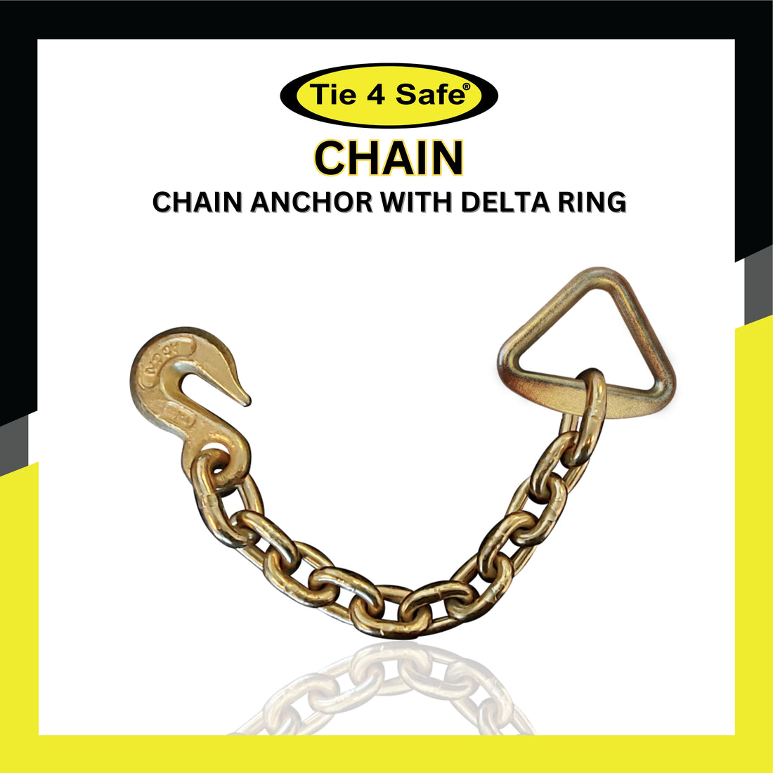

    Depending on the RGN setup, you might need some of these
    Most of our RGN trailers only have D-rings or the cutouts in the frame, they don't have anywhere to attach a regular strap or rachet. These allow you to connect a 4" strap to a D-ring. You don't want to have your straps hooked under the deck to the inside lip of the frame, any little low clearance drag will take a strap out.

    Thank you for the info, you're right, I've never seen that kind of tie down but it makes a lot of sense, pardon my lack of knowledge but I'm new in this Lowboy/RGN environment, be safe!!
