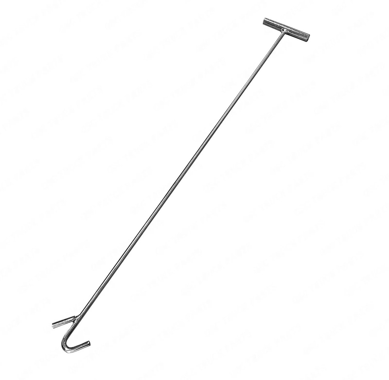

    Using a pin puller may help,it also helps to avoid getting greasy.
