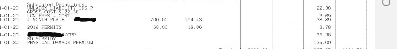

    I had my own plates, I guess I over guesstimated a few bucks.

    There are other charges. $1000 for escrow and more if you buy the omnitracs eld.

    As to the base plate..
    I have my own.... 1st year was $1,450.. cash
    Each year after that it will change depending on the miles and states you run.....
    I've never had to pay over $1,600
    My base plate is TN

    So, (and again, I’m knew you all this) if I get my own plates, does that mean I need to get my own bobtail/unladen, or can I use Gallagher or whoever it is that Landstar uses? And what other things would I then be responsible for if I get my own plates versus using Landstars? Does Landstar still keep track of IFTA and other things?
  9. flood
    flood Road Train Member
    4,164
    4,035
    Dec 25, 2010
    If you get your own plate
    YES you can use Gallagher if you wish
    YES landstar will do your ifta
    If you plan to get your own plate or go with a landstar's plate you must first file IRS form 2290.... it's $550 per year. It's due 7/1 and must be paid before the last day of Aug.... first year is prorated... so say you did it in may you would owe 2 months (may, june) then in July you would owe $550....
