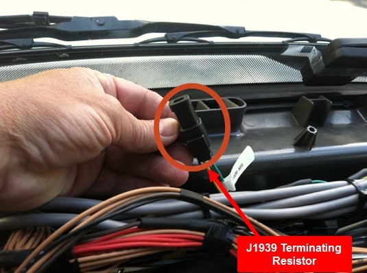

    The J1939 terminating resistor is located behind the radio near the windshield.

    Thanks for the reply. I wonder if "no trans" means it's not detecting the transmission. Or does that mean its transmitting info with that J1939 resistor?

    I’d say it’s not transmitting, no transmission wouldn’t keep it from starting
