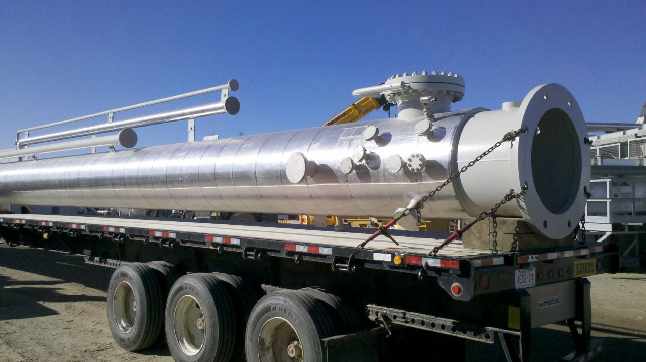

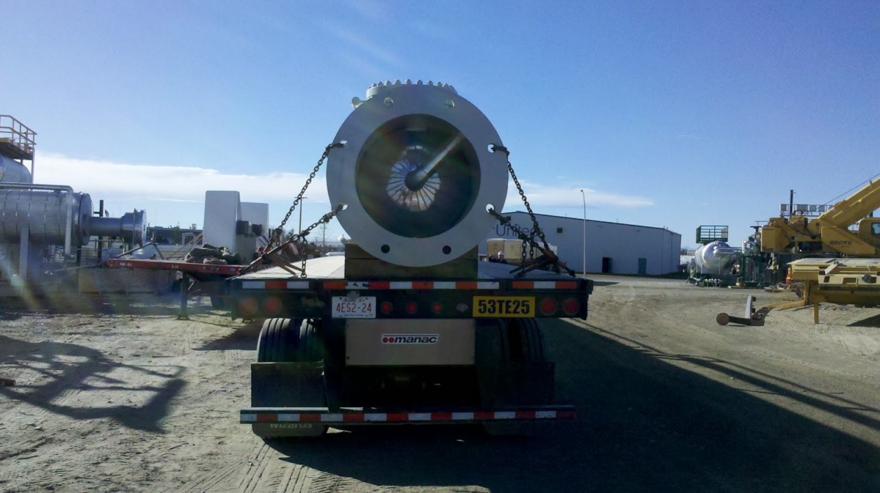

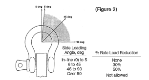

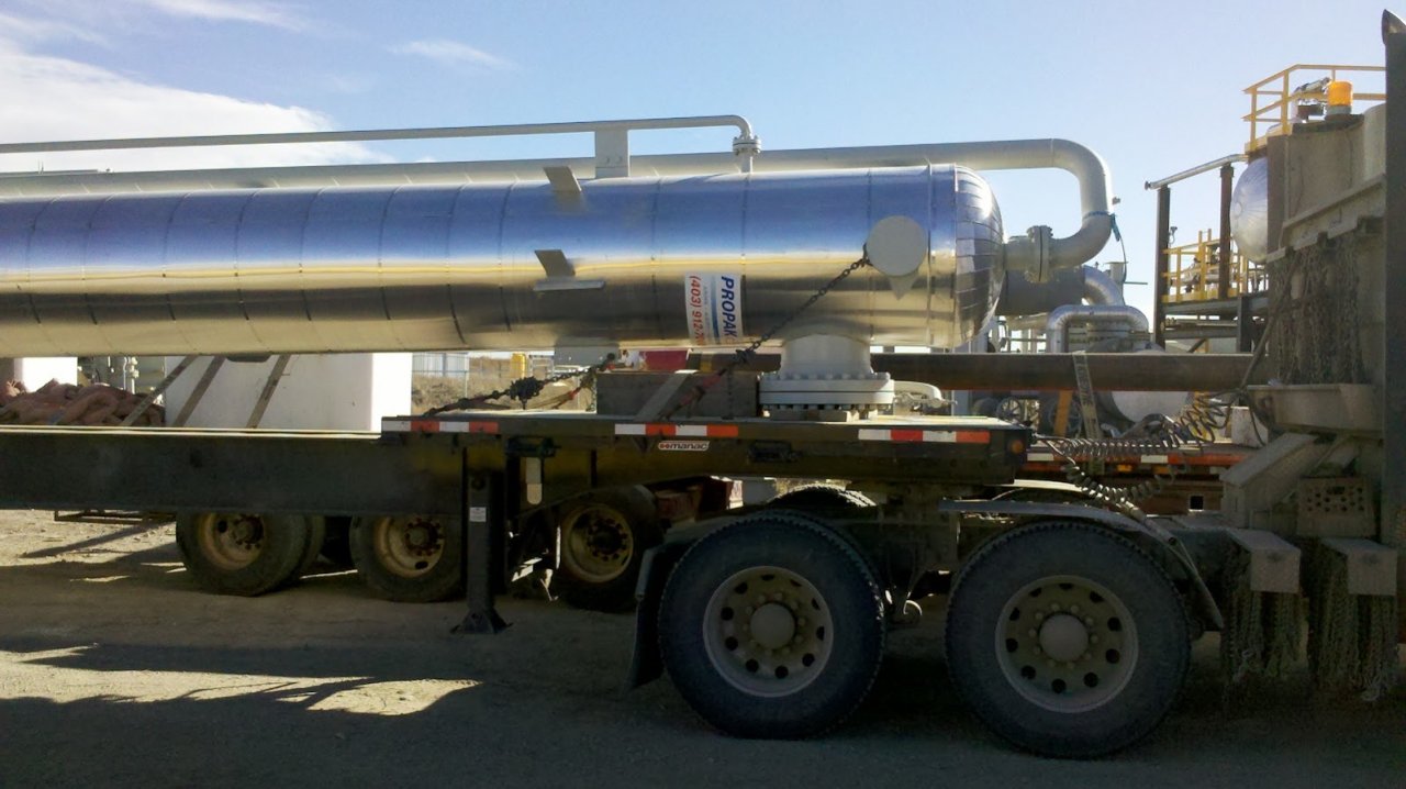

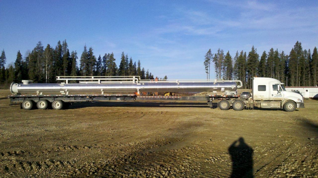

    Similar piece (insulated) 75 feet long, secured at the ends only. This one had holes large enough that I could pass the chain through, but I have moved lots of smaller ones using shackles (I do use a shackle on the bottom tab at the front of this one). Make sure your shackles are WLL stamped (and adequate) and you know how the WLL is affected by loading.

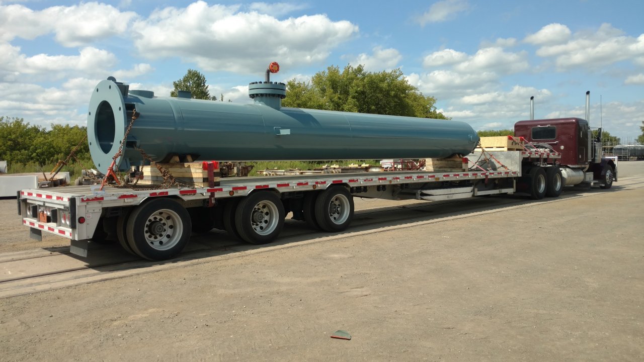

    Two other guys hauling the same piece tossed a few straps over and left.
    No thanks. I like my way better.
