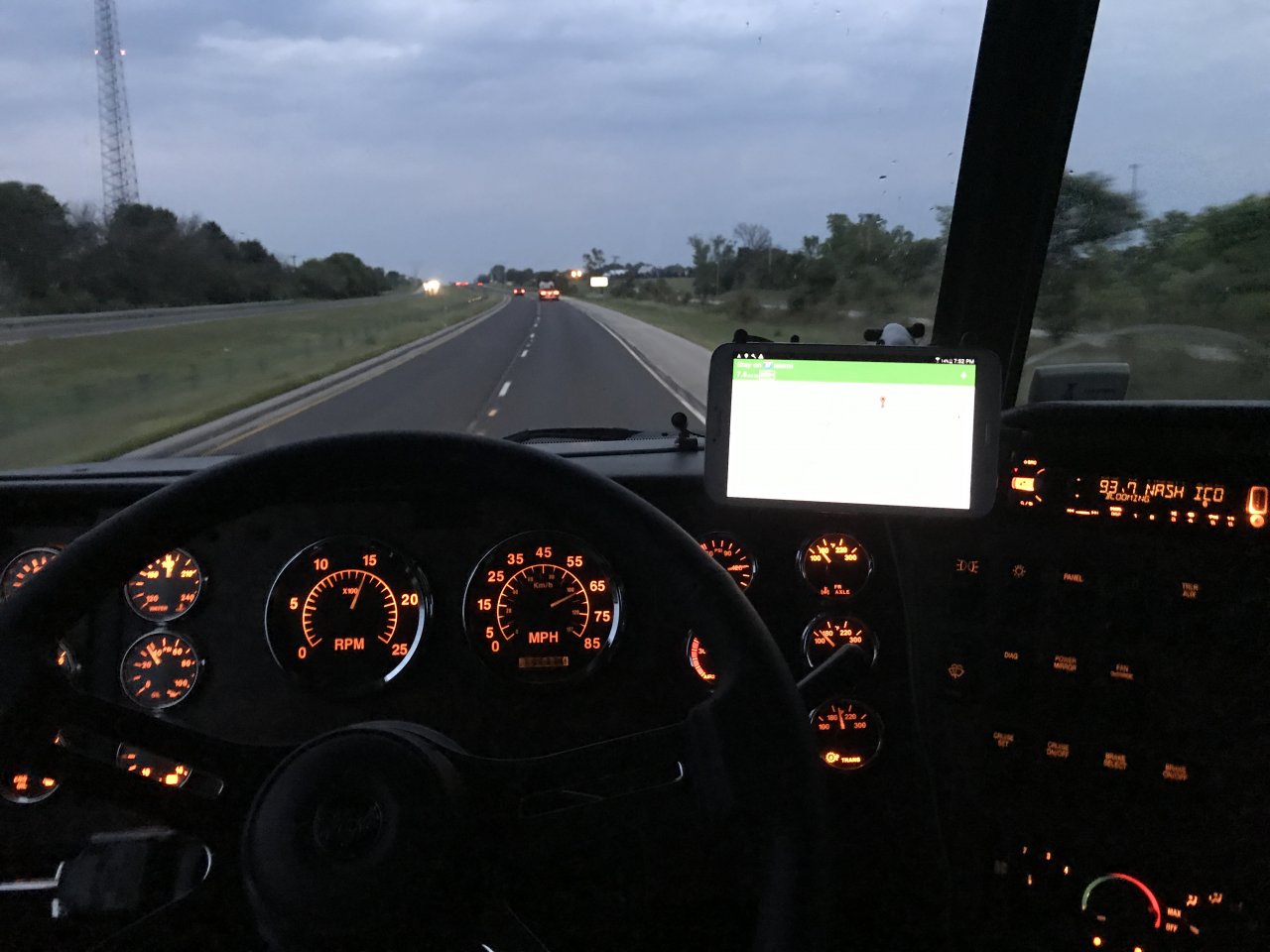

    I don't have exhaust temp ... but I do have voltage.

    The plethora of gauges in a better-spec'd truck isn't just for show, or measuring the length of anatomical features. It's your insight into how the truck is operating. Exhaust gas temp on a diesel can be an indicator of how hard the engine is working and if it's working correctly. Manifold pressure can tell you if the turbo is functional, and give you a tip toward a boost leak or tuning issue. Axle temps can rise above normal operating range if there is something wrong or the gear oil is low. A functional voltmeter/ammeter can tell you what's going on with your alternator and batteries.
    Yeah, I know...a lot of newer trucks hide all that data in the electronic dash or console somewhere, but it's preferable in my opinion to have it on display while in operation. After some time in your truck, you learn where all those gauges are during normal operation, and when something is off, it tends to catch your eye. Early warning of issues and being able to preemptively handle them is a big part in running a successful operation.
