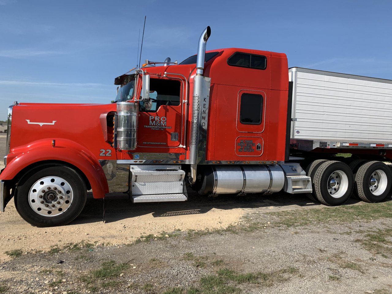

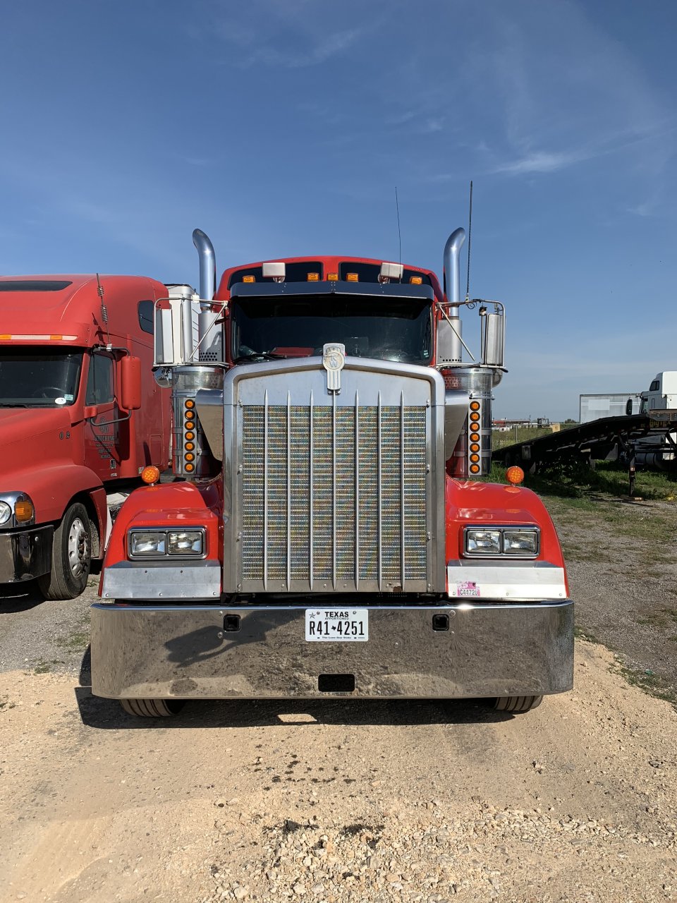

    I can run this truck for two years and probably sell it for close to what I paid for it. Can’t do that with a new truck. Also taking time off without payments is relaxing.
    As for 12.7 Detroit, I avg lifetime maybe around 6.6mpg but I get 7.5mpg a lot on light loads on flat land. 80k lbs through Virginia I-81 is around 5.5mpg. Also rebuild kits are ridiculously cheap. In a few more years I can rebuild the engine, tranny, read ends, and repaint it for less than any used truck at Arrow and will be far more reliable.

    That’s a nice Truck, what year?98,99? Hard to find those and 379s with Detroit’s. Everybody had to have a Cat. Seems Detroit has taken over the “Die hard “ category.
    rank Thanks this.
