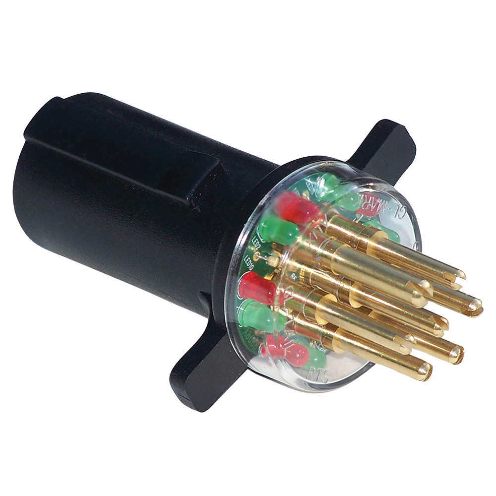

    Verify that the male connector doesn't have vertical play. The problem could likely be in the bulkhead connector of the trailer. You should only have 2 points of contact: which gives 4 testing locations; 2 male, 2 female. Whenver I do electrical diagnostics I follow these few steps: 1) check common failures, physical damage, and ground, 2) isolate the circuit, 3) check resistance/diode tester check, 4) load test circuit for voltage drop. If you can't find the issue within those four steps. You're most likely in the wrong area of the problem. Whether you're a driver or a mechanic I recommend owning a
    7-Way Round Pin Tractor Trailer Circuit Chaser™
