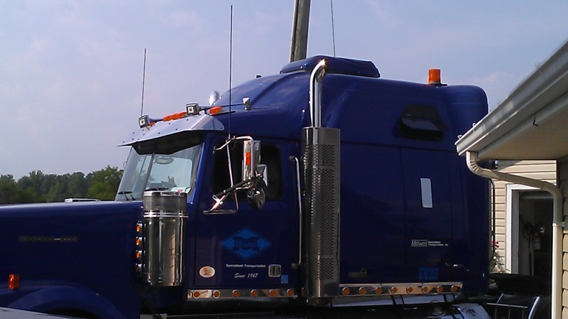

    EU3000is, home made brackets etc, wireless remote start, runs 12hrs on 2 gallons of gas with the AC on full. Holds over 3 gallons in the tank.
    Quietest thing out there in my experience, and never gives me a lick of trouble. Had them on the last two trucks, along with a Dometic rooftop AC unit.
    Money saved is outrageous....
    Yeah, I kept meaning to make a front cover for the generator, but the weather just doesn't bother it, and I always forget when I go home!
    I also run a Xantrex inverter/charger, so the batteries are always topped up
