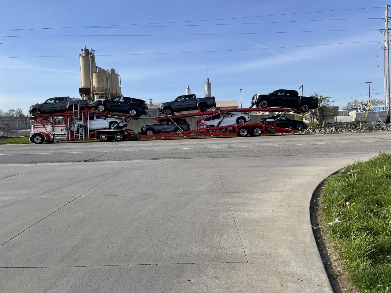

Well I am definitely not an old time carhauler but I do have 10 years of Carhaul and 35 in trucking. Maybe I have got used to it but I really don’t notice the load moving much. We sit so low to the ground we are actually less top heavy than many trucks on the road. I still take ramps and curves at or slightly below the posted speed limit. Generally the units bounce in the same direction and if you have proper spacing between units they won’t hit each other or the rig. I also feel that since the load is distributed over nearly 90’ of space it rides very well. This was my first load of the day and while it is nothing special, my rig was clean and it’s a nice spring day. Very good day to be a carhauler.
Flat Earth Trucker, Sirscrapntruckalot, RBP-SlingShot and 5 others Thank this. -
