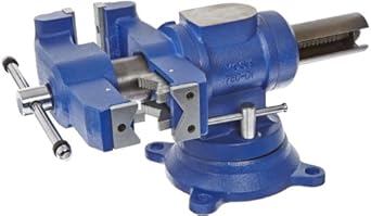

    Got this at least, it's pretty hefty at 10 inches long. Shouldn't be used much outdoors though, it says not to expose to extreme temps, humidity, direct sunlight, dust or sand, do not submerge...
    Has its own case, including an adapter and procedure for checking calibration on a 3/4" torque wrench using a bench vise (the adapter socket has flat sides for that). I'm also going to test one of those 1:58 torque multiplers with it, got a 1-inch x 4-point socket for the other end, so I can reduce and turn it with a small torque wrench (found one on sale for $10, it's 20-200 in-lbs), I'm thinking around 100 in-lbs should do.
    Entering the testing phase, stand by... wait, I don't have a bench vise yet (just an old mangled one, but this is precision work). I think the swivel head type with a pipe clamp on one end would work for locking a wheel bolt in place so I could torque on that too. :idea1:
