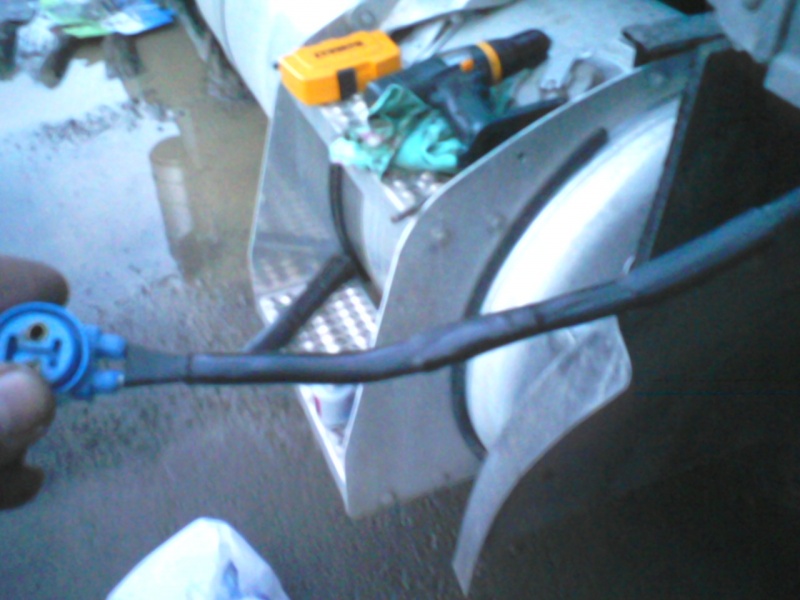

    I was working on my trailer and fixing lights and wiring issues and people thought I had a yard sale. :biggrin_25525:
    Heat shrink connectors and heat shrink are you friends when you run North. Every cheap splice and repair falls apart and costs twice as much. I do carry lots of parts and tools. Just spent a couple hundred dollars on a kit full of air fittings at NAPA and added all my loose ones in there as well.
