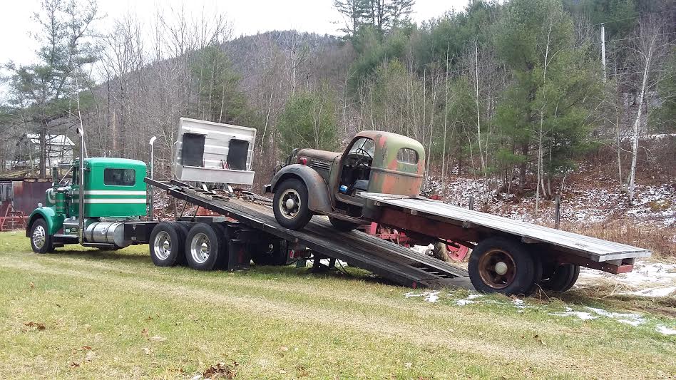

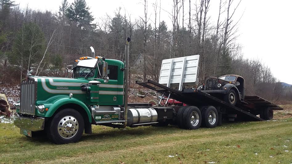

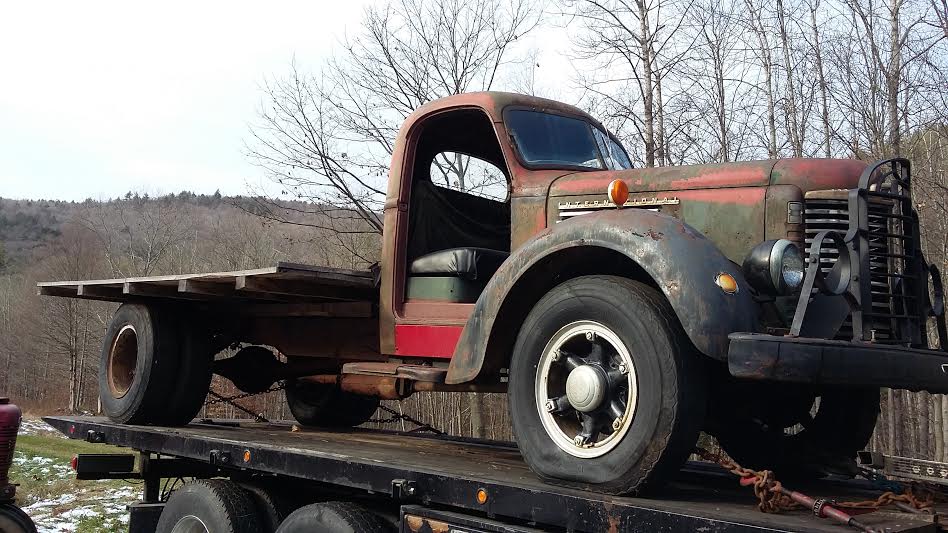

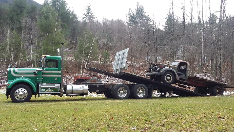

    On a lighter note. I had the privilege of hauling an old beauty today. Had a call to move a 1946 International KB-7 ton and a 1/2 truck... KB-7 IH #1.jpg KB-7 IH #1.jpg KB-7 IH #2.jpg KB-7 IH #3.jpg KB-7 IH #4.jpg KB-7 IH #5.jpg KB-7 IH #6.jpg KB-7 IH #7.jpg KB-7 IH #8.jpg KB-7 IH #9.jpg KB-7 IH #~10.jpg ...just a short 30 mile run before dinner today. Good thing it was BEFORE dinner...cuz I'm in no shape to after the feedbag I just emptied, hahaha.

    I like the deer butcher up front, looks like the truck has glasses on

    That makes the whole look of the truck to me.
    Yeah, they look like John Denver glasses on there.
