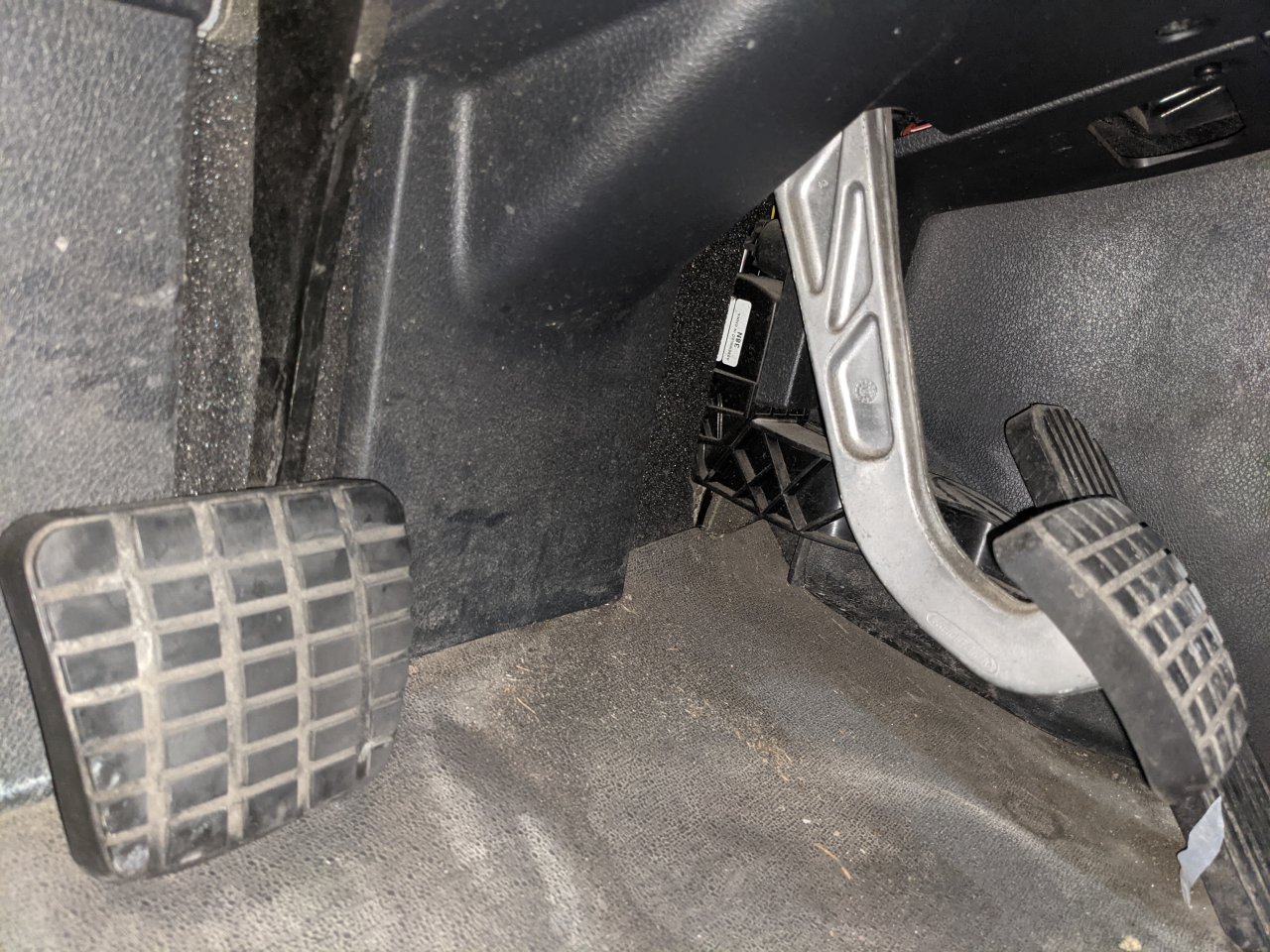

    Well, my day, and my trip have gone to crap.
    What you see below is my clutch pedal...and it's on the floor.
    Was coming across Wyoming when I came to some stopped traffic in Rock Springs. Hit the clutch to put the truck in gear to roll forward and the pedal went to the floor and stayed there. Fortunately I was on a downgrade so I could roll forward enough to slip it into gear and stay waaaaaay back off of traffic so I could stay moving. I milked that sucker all the way to the Cheyenne yard, and thankfully there is enough of a hill on the loaded trailer drop area I could start rolling back so I could slip into reverse to back up. But the fun part, these new trucks won't let you start the engine with it in gear, so I had to wind the landing gear down more than I should so when I dropped the airbags, I had no pressure on the 5th wheel. Then it was start the engine, and just as it fires up, slip it into granny and pull away. Then, I had to drive right up near the building to get enough of a reverse roll bobtail to get into reverse to back up with the rest of the bobtails for the night. I checked the master cylinder and it is bone dry, and it had fluid in it earlier when I was checking the oil...so I either blew a slave cylinder or a line because I don't see any signs of a leak inside around the billows or on the firewall. So now I get to wait until morning because breakdown says to take it to Freightliner and they closed before I got here.
    Bumper, Rugerfan, Winnyf1 and 5 others Thank this.

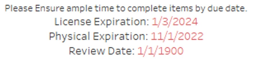

    Asked why my review date year shows 1900...was told Creaffer thinking about no longer doing ... yearly annual driver review Screenshot_20220518-083024_Adobe Acrobat~2.jpg
