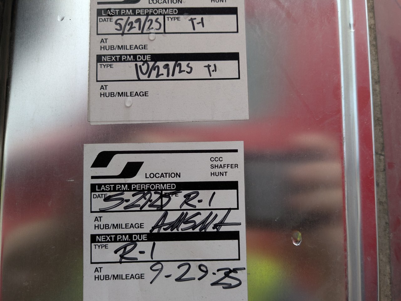

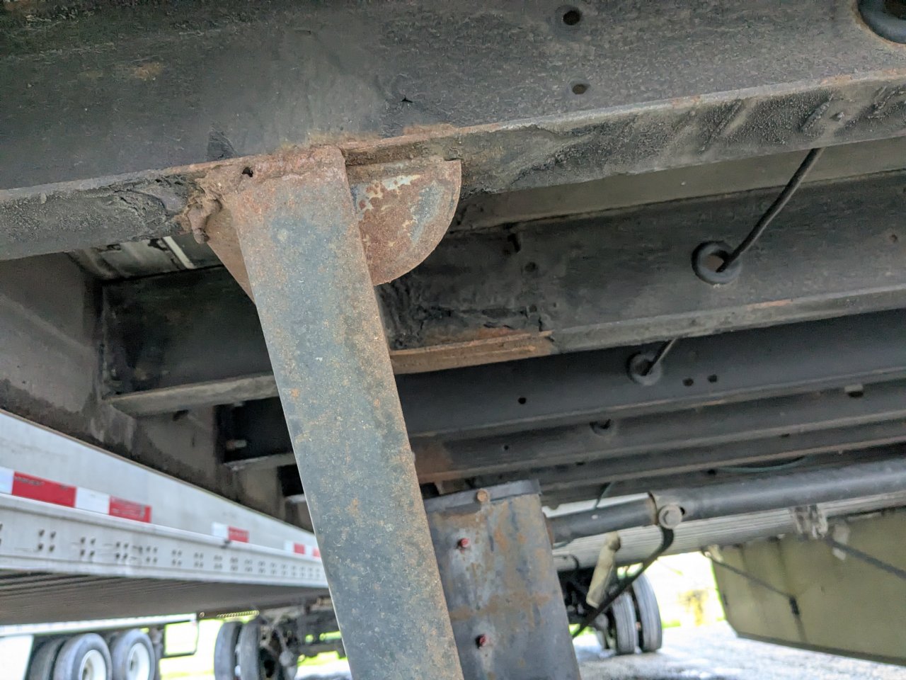

    I looked at the trailer with the wonky landing gear they're talking about. It was recently inspected and serviced on 5/29. The problem with the landing gear is that they were replaced, but whomever replaced them, welded the top mounts 6" farther out than they're supposed to be, so the distance between the top of the legs is a foot wider than the bottom, so it is bowlegged, which has now bent the big plates on the outside of the legs that keep the landing gear from folding front-to-back.
    Just got off the phone with breakdown...surprise surprise, they said nobody had reported it to them, so now they need to get a driver to bring and empty down from Columbus and take the bad one back for repairs.
