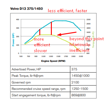

    Is this more or less what's happening? It also said to never spec beyond 1550rpm cruise in the same document, I'm not actually choosing a 375/1450, it's just an example of the curves.
    The transmission and rear ends need to be specced to get the horizontal flat lines as close together as possible? Is 1350 ideal in this?
    Siinman Thanks this.

    Yep you are getting it. Also there is a formula that you need to understand for how much Torque is needed per LBS you are driving to really maximize the way to use the charts. Once you understand what weights you are gonna pull you can bring it all together for the best MPG's. If you have Facebook or X account I would follow Joel Morrow. He is a Volvo guy and helps spec's equipment and runs unbelievable MPG's in his set ups. Henery Albert is the guy to follow on Freightliner stuff. I do not know anyone that is big on Kenworth stuff for MPG's. I am a Volvo guy and can answer a lot of questions about them if you need some help on that stuff.

    In this example it depends on weight and gears RAR's. For something like my set up being it is a 500 HP and 12 speed auto with 2.79's I like to be 1100-1350 for most my loads. 68 MPH is 1350 and at the top of what I want to run doing dry van freight. I can run 75 mph but it is not idea. I average 8-9 MPG's depending on weight and location. Life Time on truck is closer to 8 with hardly any ideal time since I have a EPU. Summer time I average 8.7 MPG's and winter time it is closer to 8.2 MPG's.
