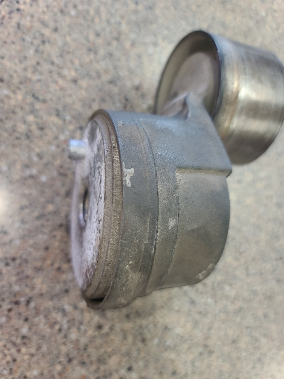

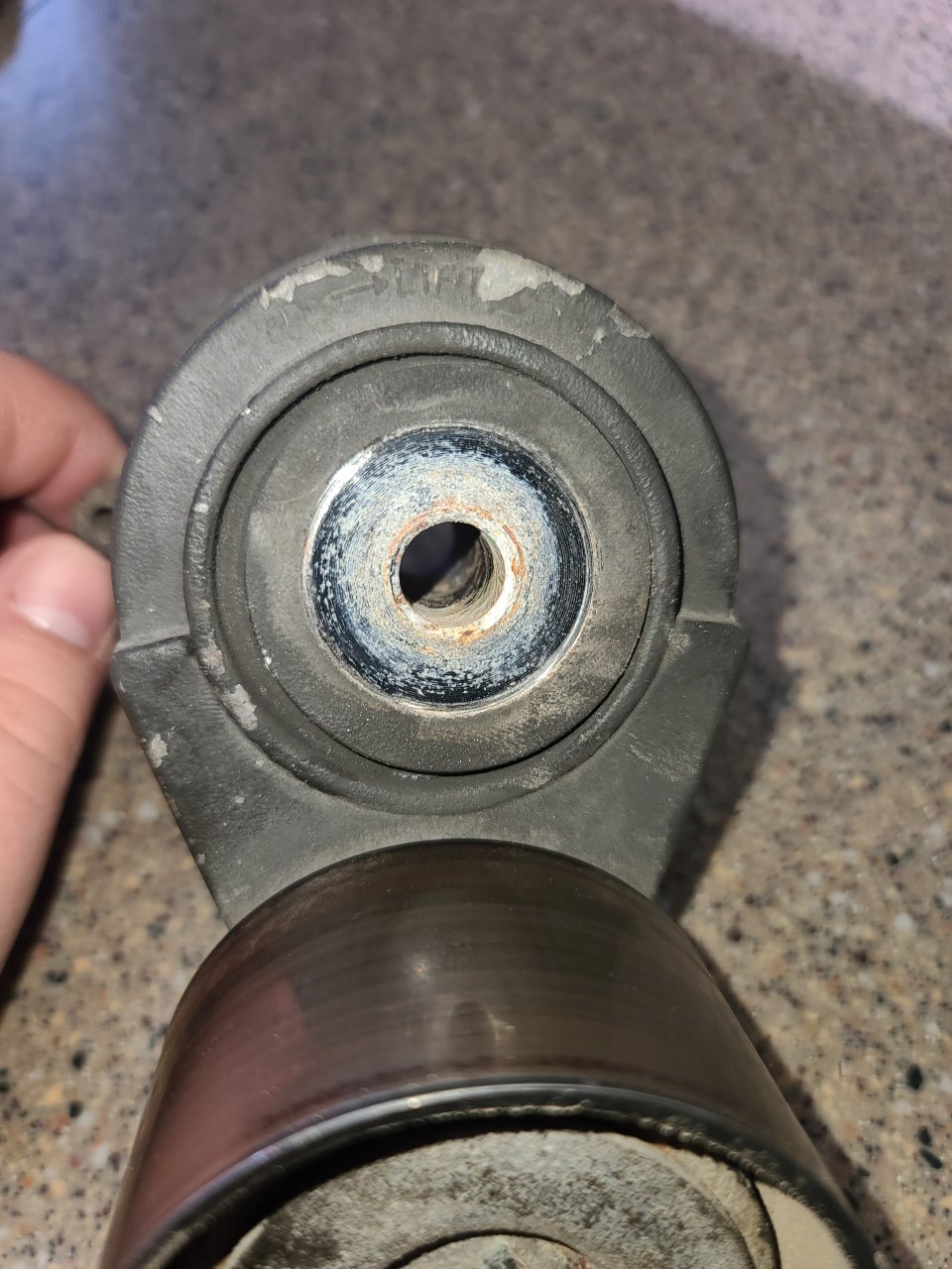

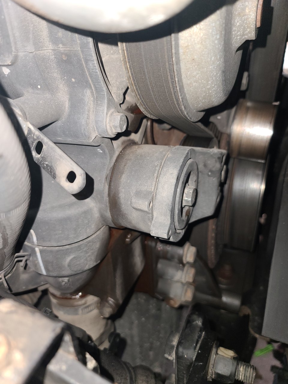

    Yup this crap right here has happened about 3 times in my rig tensioner or a roller rolls smooth but is so worn out it starts to squeel.
    Also may be worth checking the EGR valve. If its clogged in the tube it can get stuck partially open and makes that wonderful sound as well and if left for a while can cause the spindle to snap off requireing a new one...which has happened twice in my rig so far lol.
    Finally another place ive had make that noise is the inlet pipe to the SCR. That seal can go bad and begin to leak especially if the filter is begining to plug and causeing a lot of extra pressure. Wont throw a check engine either until its about to blow.
    Otherwise amodel covered everything. Oh as an after thought, check this tensioner in particular. It is the bane of my bloody existance. I had a streek of 8 of these go bad in a month due to poor manufactureing causeing them to just die on me and it tends to fail every 100k miles or so on MY engine, even though thr factory one went to 600k. Worth looking at anyway.

    Yeah I was wondering about that. Makes sense that higher rpm could could change the dynamics of the tensioners. I'm going to replace it for sure.
    Wow! 8? Got any recommendations on where to buy the tensioner? I'm definitely going to clean the egr because I threw a def relay code a couple days ago. Anything Def related terrifies me after spending $8k on it last year. Where is the SCR seal located? and do you have a part number for it by any chance? Thanks

    The scr seal is where the pipe goes into the back of the SCR. I dont have a part number handy sadly its on my repair paperwork sitting in its box back home. But just have pete do an exhaust leak test. If its bad you will see soot or it will ROYALLY fail a spray test. As for the tensioner just get the paccar one from them directly. It usually ends up lasting to 100k. The knock off ones are poorly built garbage.
