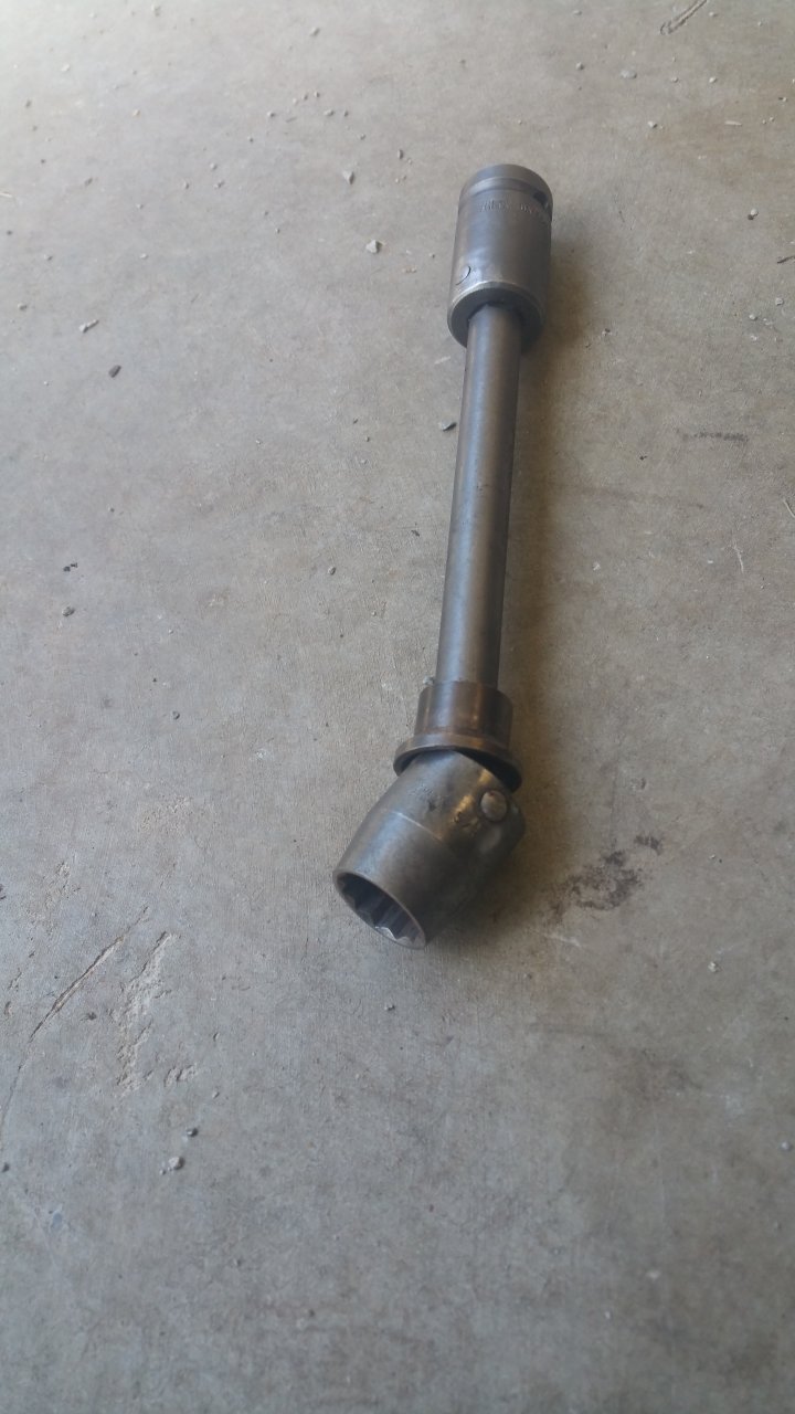

    Pic of the starter bolt removal tool it's 1/2" drive.

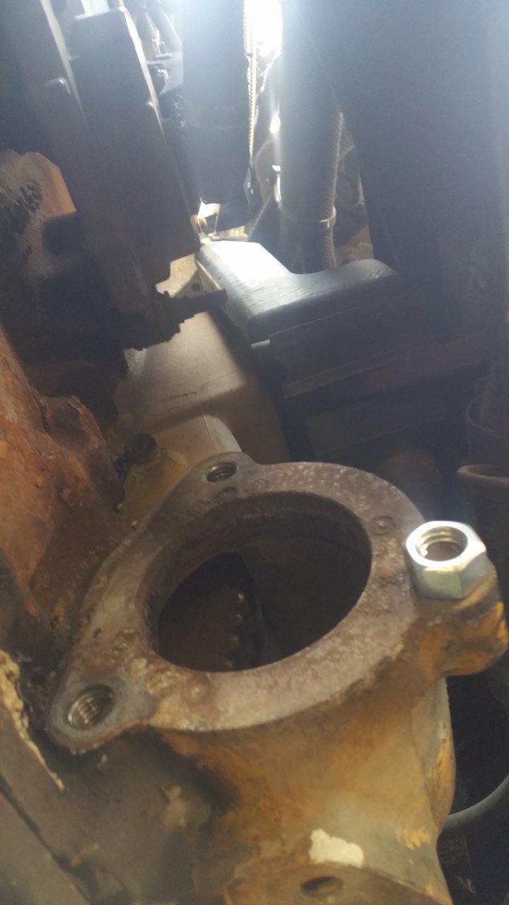

    @rollin coal , if you have any decent size flat washers, take 1, weld it on as close as you can to the flywheel housing, let it cool. Weld another, let it cool. Weld 1 more on. Let it cool then id weld the nut on and try to back it out.
    The heating and cooling can be really good at loosenin up a broken bolt. I have done that many times on broken exhaust manifold studs.
    Good luck on that one man.
    rollin coal and SAR Thank this.

    Got it this time. Welded the nut on there good then heated everything up as red as I could get it with my propane torch. It backed right out... whew!! That has been on the back of my mind for 5 years now bothering me now it's fixed.

    So that's what that tool is for! I've had one of those in my box for 15 years. Always wondered what it's real purpose was.

    How much did that tool cost you?

    I hate to say, call CAT and price one make sure you're sitting down, lol. But you know what I don't really care. It's a good tool that works great for that job and whenever I need to change a starter it'll be a quick easy job. Pic of the broken bolt. 39MT sounds funny compared to the old 42MT but it works and doesn't go click, click, click...
