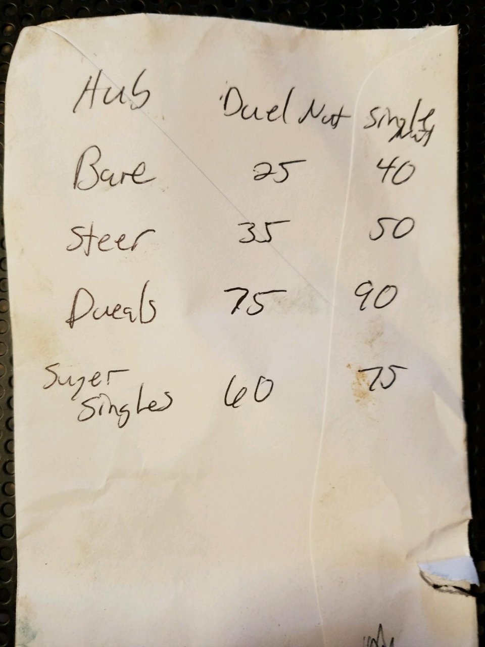

    I wrote these torqing specs down 10 years ago listening to Mike Becket at MD Alignment. Never had a problem. 25 ft-lb is for the inner nut when the hub is bare; 35 when the steer tire is mounted; 75 when duals are mounted; & 60 when wide single is on. If course torque the outer nut as much as you can (300ft-lb).
