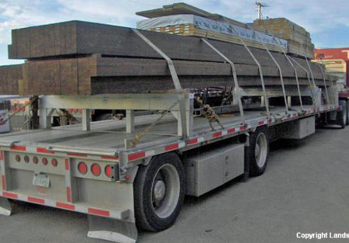

    53 step gives normally a 43 foot bed container locks for two twenties load levelers and if they don't like it next guy will. most places will load and use this setup if you really want some fun add a set of ten foot slide out ramps!

    Interesting stack... A couple of Qs. How much extra weight does load levelers and ramps take from payload? Considering a step weights 2k - 3k more than a skateboard.
    Looking at the load in the pic, would loading the smaller bundles under the [beams] work? Securing of course would have to be independent to not bare any load of the larger items. Thinking of keeping the load height and CG as low as possible. I'm thinking there may be times when a shipper would refuse to load out this way.
