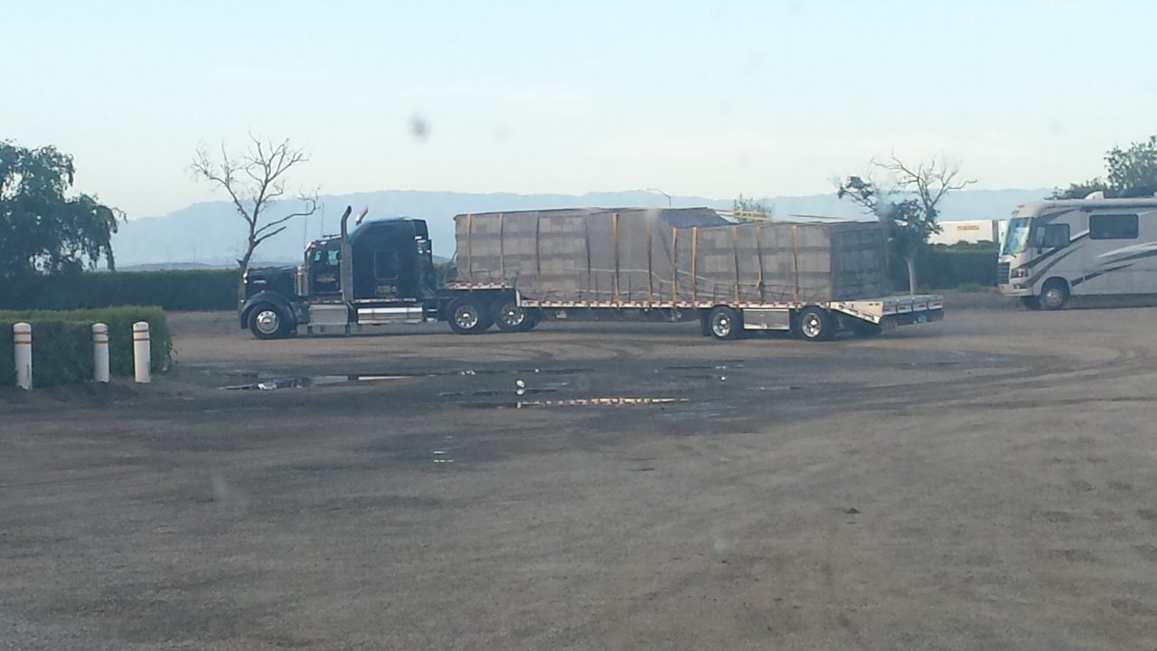

    Thought this was nice
    20170326_074720.jpg .

    That's a nice setup.
    Not to take this off topic, it I have been wondering quite a while about a step like that trailer with a dovetail and ramps. what are you veteran stepdeck guys opinions on that setup?
    I have hauled a stepdeck a little and a lowboy quite a lot so I like hauling equipment. I'm hauling cattle now but with the mandatory elogs that will make me change avenues and I'm really interested in stepdeck, but if I was to buy a step I would want one like that in the pic with a dovetail and ramps. Kind of seems like that best all around trailer in my opinion. What is the opinion of you veteran step deck guys?

    I've been doing open deck work my whole adult life....not sure I qualify as a veteran step deck guy; but in my opinion a step with a dovetail is useful for really niche work more so than for general freight. I have in my trailer stable a flat, step, 3 axle step, dump trailer, walking floor, and most recently an rgn with a mini deck on the neck. For all around general use my go-to step would be a 50.5' with 40' bottom. R/A slide. HD ramp kit. Pick your composition according to your checkbook and need for weight savings.
    Just my 2 tin pennies worth; but we do have a resident professor Emeritus from the National College of Stepdeckology who posts on here; he may be able to steer you better.

    I think that's a Wilson. Almost bought one just like it but I didn't like the weight penalty that comes with the beaver tail.
