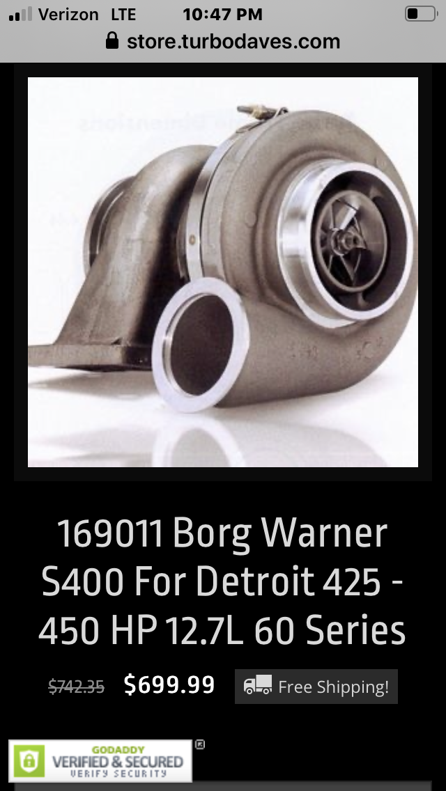

  5. Rideandrepair
    17,349
    56,289
    Aug 8, 2015
    D4E5DEB5-CC10-4F47-805E-8E5B95D4F10E.png Turbodaves shows this one for 12.7, Same part #s.
    650cat425 and blairandgretchen Thank this.
