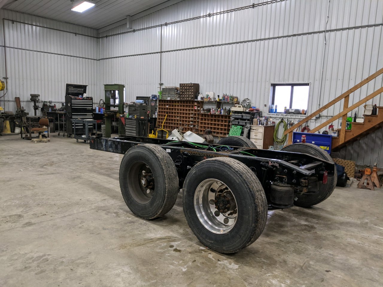

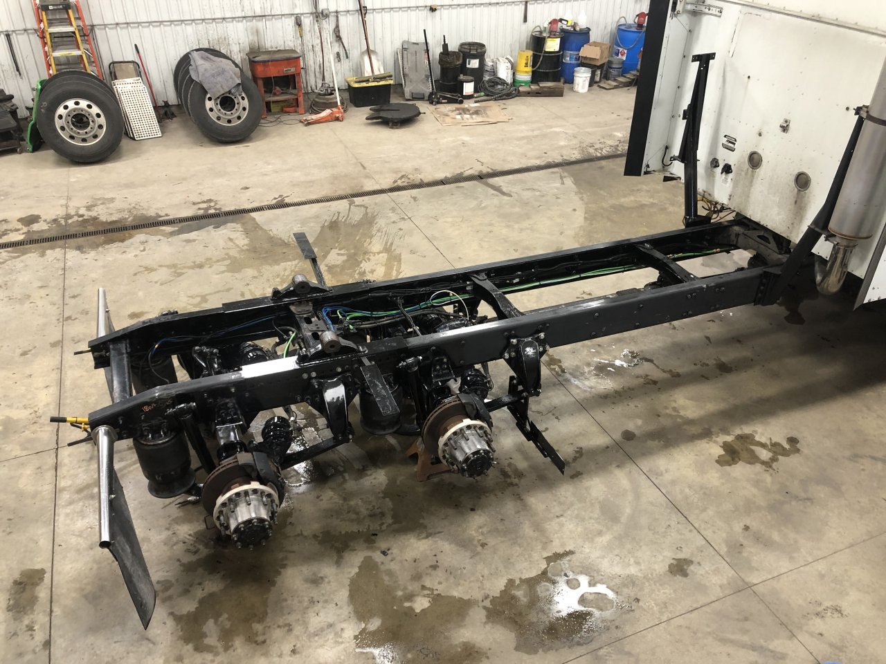

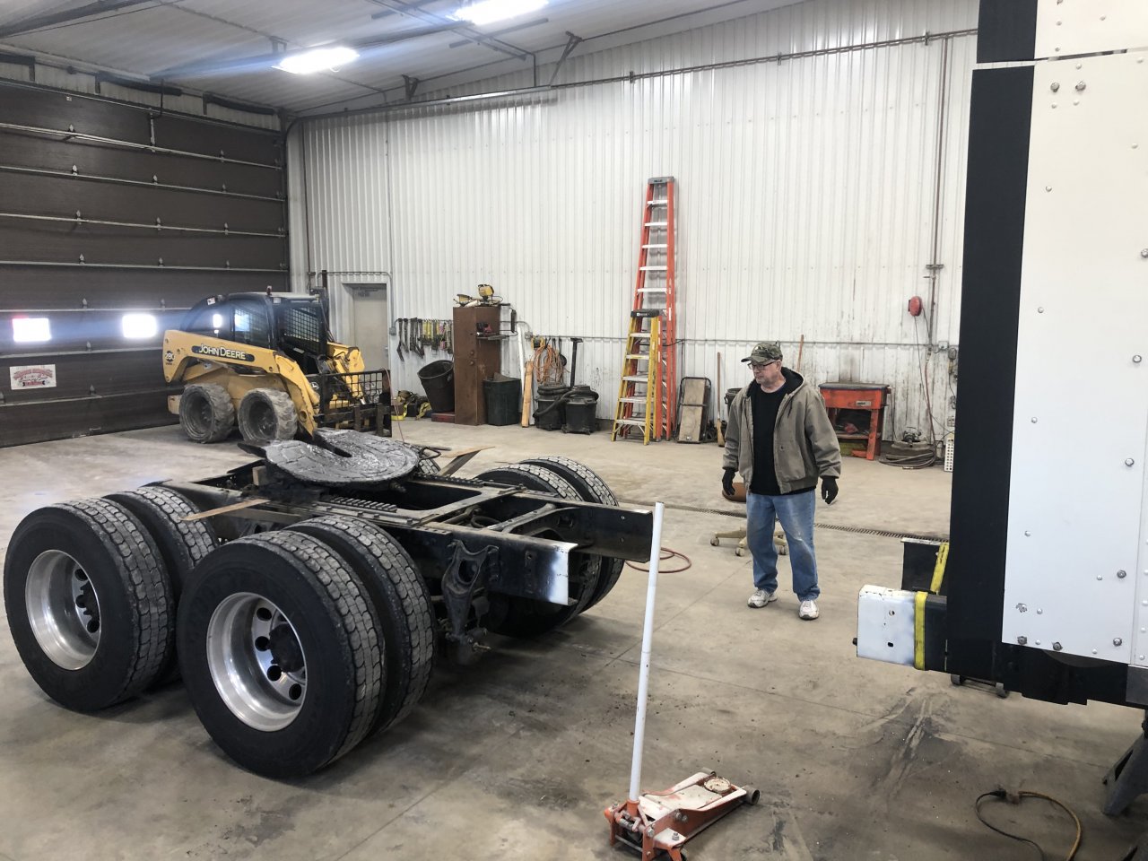

    Found a 60k mile freight liner disk brake cut off for under $4k 2AF5D755-DD27-49F4-9508-115EAF194F6A.jpeg 1F96B7FA-8541-4B3A-829A-FE64543F1849.jpeg EEDD18B0-07D6-41E7-A48C-AE0665877562.jpeg replaced the 1million mile back half over a couple weeks…….
    priceless!!!!
