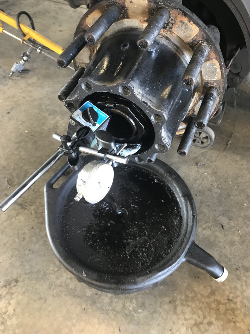

    He is correct. The only way to check wheel bearings is with a dial indicator. Brakes make more heat on the hub than the bearings will even if out of adjustment. Unless they are toast. Mine appears to be the originals with 1.1 million miles. F95A089D-D437-46DE-8B3E-2D6D45DF1335.jpeg I run mine at .001 to .000 end play. Think the book calls for .010 to .005?every set I’ve ever checked were way lose.
    And if your hub is ever so hot you shouldn’t touch it with your bare hands you got major problems and you will smell it before you get your hand near it. Don’t think I’ve ever seen mine more than about 20 deg above ambient temps before or after I adjusted them.

    So you never know how good or bad the wheel bearings become (except abnormal tire wear or wheel wobbling) unless you use that gauge? When does it need to be done, as a precaution, every 500k miles, 1 million? I was hoping there could be some other external indicators.

    I checked mine when I bought it at 700k then of course every time a wheel seal goes out you need to set it. I will be checking mine again when I put on new drive tires. I currently have 360k miles on my drives. So maybe again in the fall ( 400k) ?
    If it’s wobbling it way way to late.
    ps I have one tire wearing like that on the inside and it’s the one that I had a shop on the road changed the wheel seal and set the bearings. Started chopping within 2k miles. I reset the bearing ( because the new seal failed by the time I got back home) . But it was to late the tire is now choppy. Was just fine before wheel seal was changed.

    The only way you could kinda check is to Jack it up and release the brakes and pull up and down with a pry bar. You shouldn’t detect any movement. Anytime I jack a axle For any reason I do this. Steer, drives and trailer. That won’t help with tire ware but you’ll know if you got an issue.

    So, it might be a good idea to spend a few bucks for all the bearings to be measured for excessive slop every time you replace a set of drives? I can't imagine that would be terribly expensive, but it would require removing and replacing seals.
    Or better to just watch for inner edge wear on the tires or smelling that funky loam/dirt/rot smell of leaky/overheated bearing grease, and count on those things to tell you when there's a problem coming?
