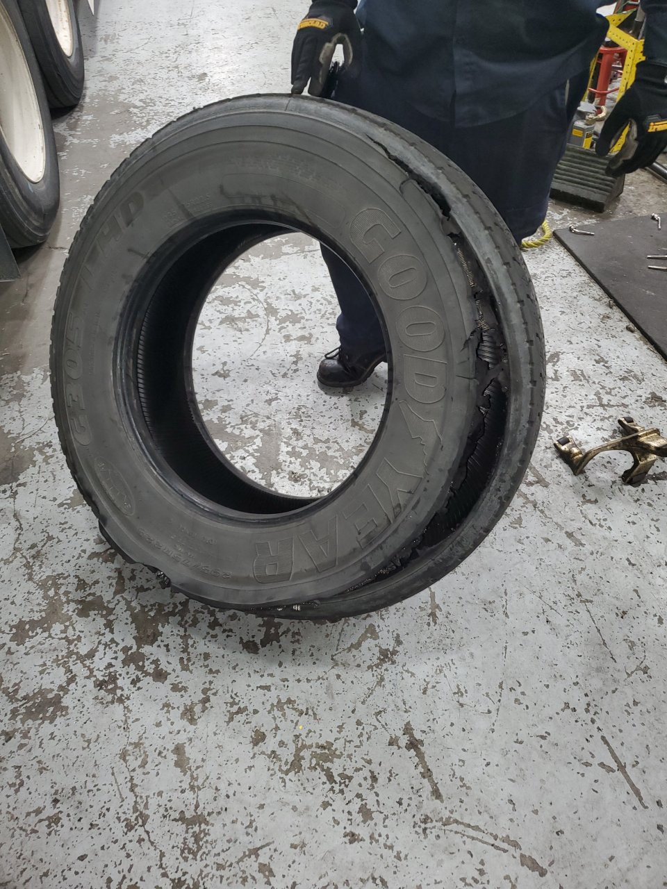

    Well. My decision as to when to replace my drive tires has been made for me.
    Lost the RFI drive at some point late in the driving day yesterday. Found the sidewall blown but the tread fully intact this morning.
    Loves here in Memphis, TX has no used tires, and I am not putting one new tire on with 7 others that have 180k miles on them.
    So. Going to put on a set of these off brand virgin drives. Doublecoin name brand.
    Hopefully buying these off-brand tires won't be too terrible a mistake. They appear to have fairly aggressive tread, so I expect them to wear a bit faster, but I can deal with that. If I pay 3/4 of the cost of name brand drives and get around 3/4 the tire life, or even a bit less with more traction, I'll be more than satisfied.

    Here's the tire. Was a recap, original tire was stamped 2013.
    Shop says they saw no evidence that the tire failed due to road trash damage, and I do actually inspect my tires every morning, so best guess is that it simply blew out in a pothole due to age.
    Rideandrepair and dwells40 Thank this.
  5. snowwy
    snowwy Road Train Member
    20,575
    13,297
    Jul 6, 2009
    Rubber shouldn't be used after 5 years. And you used a 7 year old casing.
    BTW. It's summertime. Very critical to maintain tire pressure if you're running recaps.
    Rideandrepair and Farmerbob1 Thank this.

    Aye. I check my tires every morning.

    Update. The rim that the tire with weird wear was on was unbalanced. I had it checked. It was out by 6.
    This DOES make sense. The tire had irregular wear, BUT the tire and rim together were balanced when I had it tested.
    Not sure why I didn't make that connection earlier.
    Rideandrepair Thanks this.

    Honestly that’s #### good use out of a Goodyear and recap at that.
    I just want to make sure I’m picking up what your putting down. Are you saying that even if the wheel and tire are balanced together, that due to the wheel itself being out of balance that that made your tire wear funny? I have always thought of if they are balanced together that’s all that matters? I kinda can see what your saying though if I’m fact that is what your saying?
    Farmerbob1 Thanks this.
  10. Long FLD
    Long FLD Road Train Member
    12,205
    50,490
    Mar 4, 2015
    Maybe after he noticed the irregular wear they were balanced together? But at first they weren’t balanced because of the wheel. I could understand that once it wore the rubber off quicker being out of balance.
