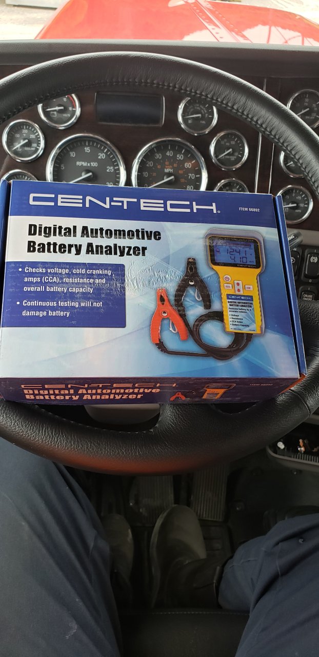

    No harbor freight near so you can buy a battery tester instead of paying dealer shop rate for them to tell you they are bad or not? Some battery dealers will even test them 4 free....
    wore out, Rideandrepair and Farmerbob1 Thank this.
  5. JonJon78
    JonJon78 Road Train Member
    7,177
    40,618
    Jul 1, 2018
    I bought this at Habor freight, dont recall how much it was though.

    I definitely need one of those. Do they test with the batteries connected, or do you have to remove connections and test each battery separately? Obviously if it detects a problem you would need to disconnect to isolate, but i am talking for first-pass testing.
