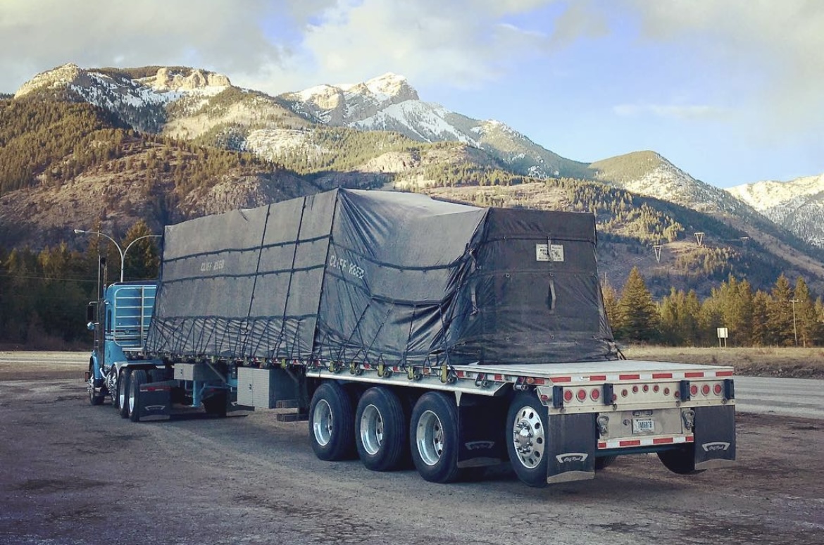

    Glad I never had to mess with flaps. One of the perks of hauling wood products I suppose. Here’s a load of 5ft wide mdf in BC on my way to Edmonton. Box end tarps weren’t ideal for this but you could still make it look good.
    Tug Toy, LTL Bull, Sons Hero and 7 others Thank this.

    Ok, after seeing that pic I am never posting another pic on this site of any of the chicken scraps I get to haul
    LTL Bull, Sons Hero, cke and 6 others Thank this.

    That shock cord looks shockingly awesome!
    D.Tibbitt, cke and Kyle G. Thank this.
