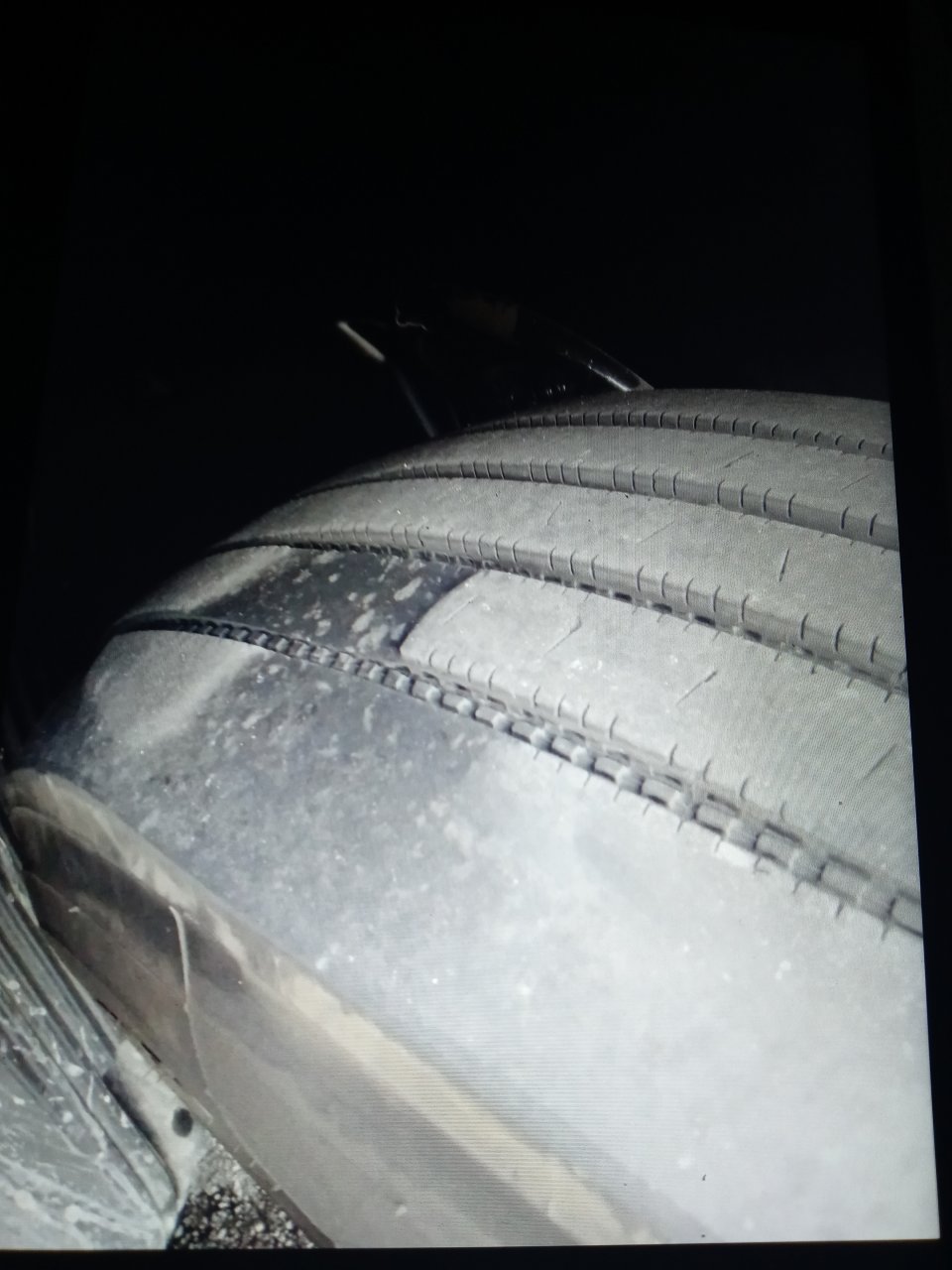

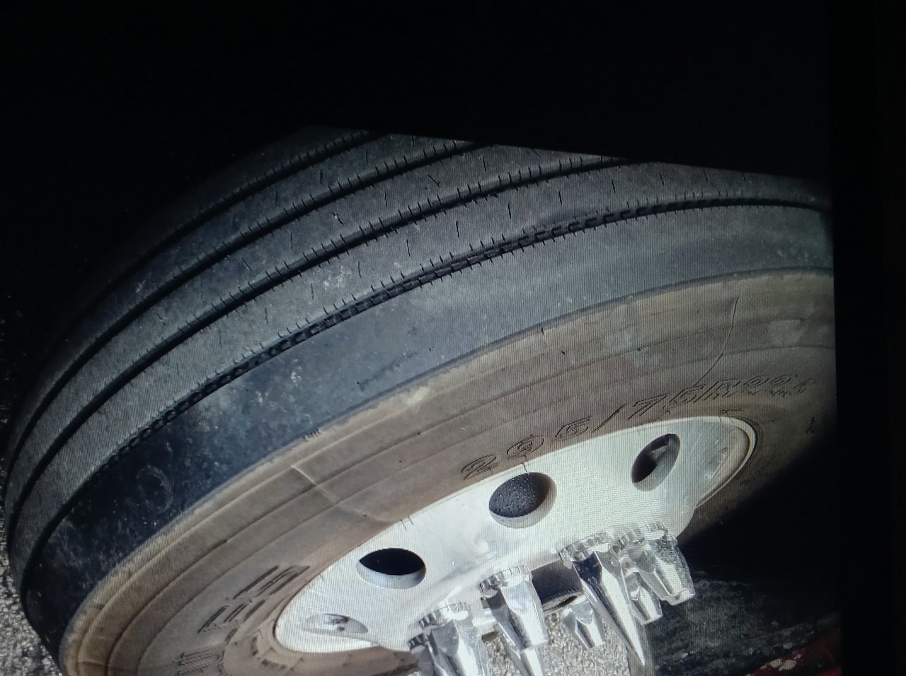

    Man that steering must’ve been shaking bad and a loud thump thump noise up front. You need to get used to sounds of your truck that way when you hear something strange you look harder at stuff.. The worst thing a driver can do is drive with stereo full blast. Sometimes a soft horn from another vehicle or a weird noise can save you big time hassles .

    Anyone else think it’s funny how the OP had no problem driving on that tire that was likely shaking the whole front end of his truck until he happened to actually look and see the irregular wear?

    Depending on the roads he's been driving on, he might not have noticed the difference between road noise and a steer out of balance. At the time of the first post, he was on US-287 somewhere between Denver and Dallas, which is not exactly the smoothest truck route in the world. If he rides bumpy roads as a general rule due to the loads he gets, he might have gotten used to road noise and failed to note when it continued even after he hit stretches of smooth road.
    That's not an excuse, it's a reason. If he reads this I hope he remembers to watch the condition of the roads and pay attention to the feel of the truck whenever he hits newly paved, or very smooth older roads.

    That said, my 2 cents: although driver was negligent at discovering this during a pretrip, 2 wrongs don't make a right, continuing to run on a questionable steer is simply not a good idea. As a driver, it is my responsibility to drive a safe truck. I simply wouldn't have driven it until the tire was replaced. If that cost me my job, so be it. A company that won't fix a steer under those conditions, is simply not worth working for. Since the driver missed it during a pretrip and when it could have been rectified by the company at a much cheaper cost, that is an issue between the company and driver and if the driver received any punative punishment because he missed some thing he should have noticed, that part is on the driver. The company, regardless, needs to get the truck safe to drive before it goes anywhere.
    I'm lucky I work for a company that is pretty good about such things. I had both, fairly new, steers start to wear in the ripple pattern. You couldn't really see it, But, you could feel it when you ran your hand over the tire. I took it to a terminal and asked the tire shop guys what they thought. They said yep that's a problem and replaced both steers.
