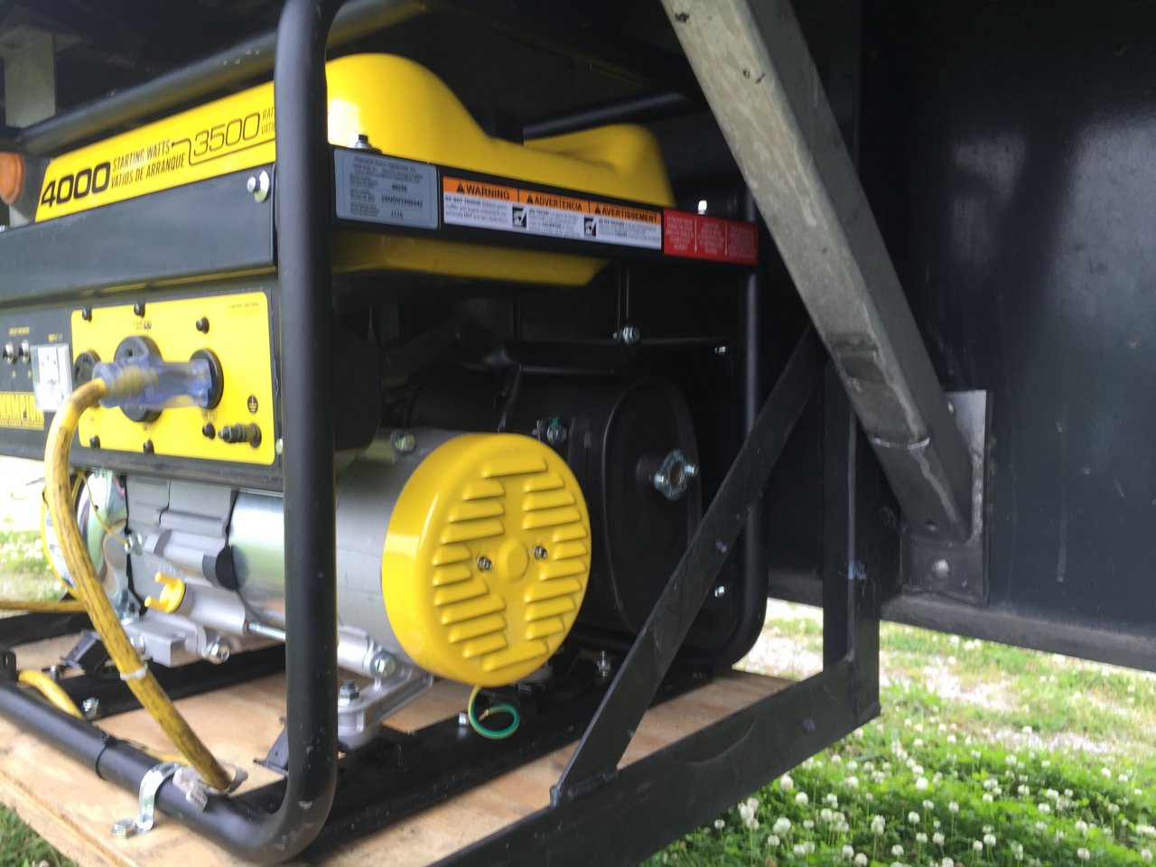

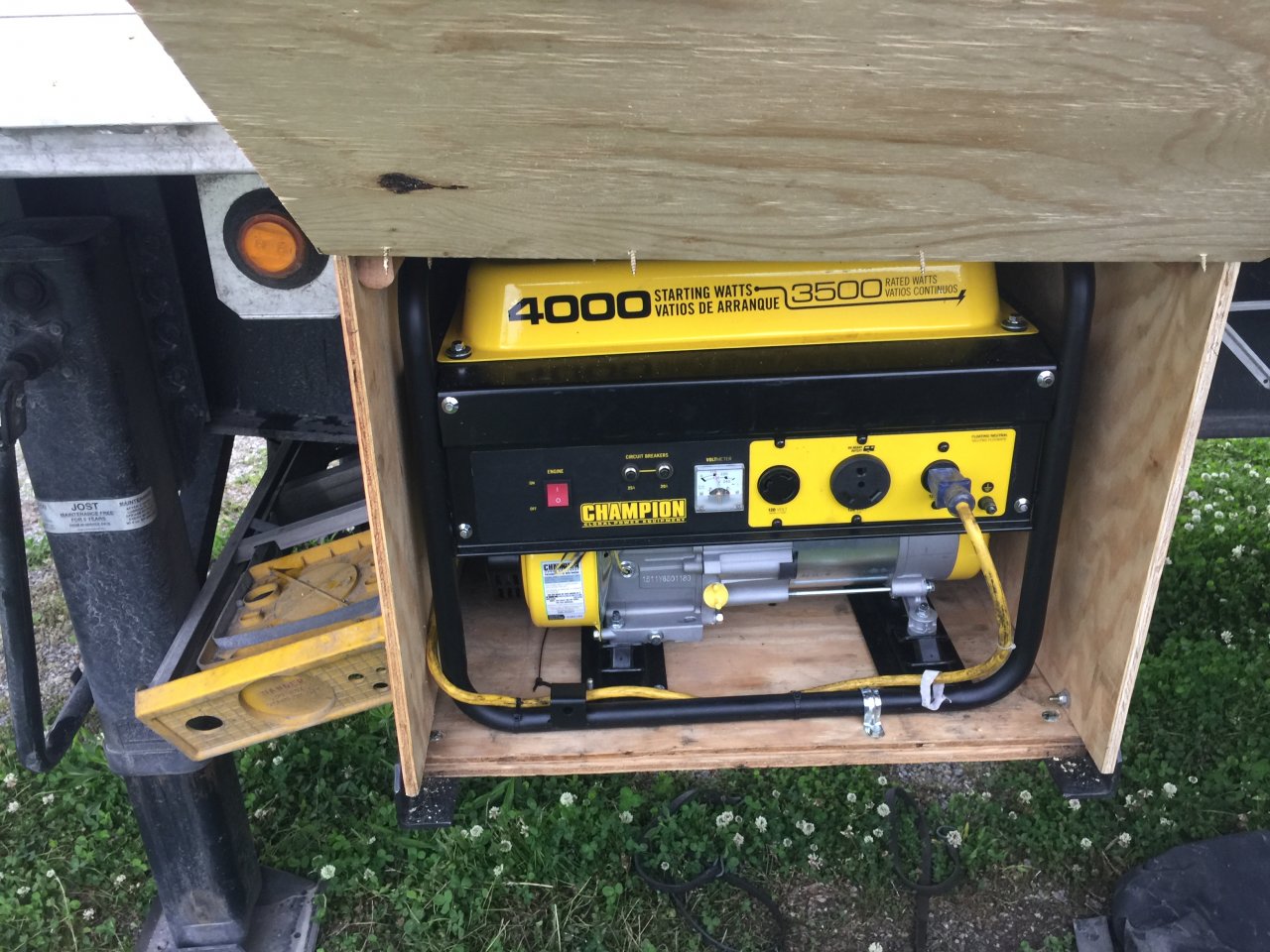

    Blair, I don't want to be a naysayer, but do you think that the heat could be a bit much for the wood? I realize that you have cut a hole for the exhaust, but...
    blairandgretchen Thanks this.
  7. blairandgretchen
    13,377
    71,913
    Dec 9, 2011
    South west Missouri
    It's got adequate ventilation from the rear. The box is just to keep water and road grit out. The rear is open.

    The biggest problem is going to be engine cooling. Heat is the big killer of an air cooled engine. There is no place for the heat off the engine to escape, other than to recirculate around and around inside the box with the exhaust heat.
    Engine heat increases greatly while under load, which the engine will be the majority of the time it is running. You need fresh air to the front of the engine where the hand starter/flywheel screen is, as this is the cooling intake area.
  10. TaylorMade407
    TaylorMade407 Road Train Member
    1,328
    1,036
    Jun 30, 2009
    Orlando,FL
    Looks like he could keep it open while it's running and then closed when he rolling down the road. Pretty nifty idea and setup if you ask me but I've had APUs in company trucks and that's the only thing I'm getting.
