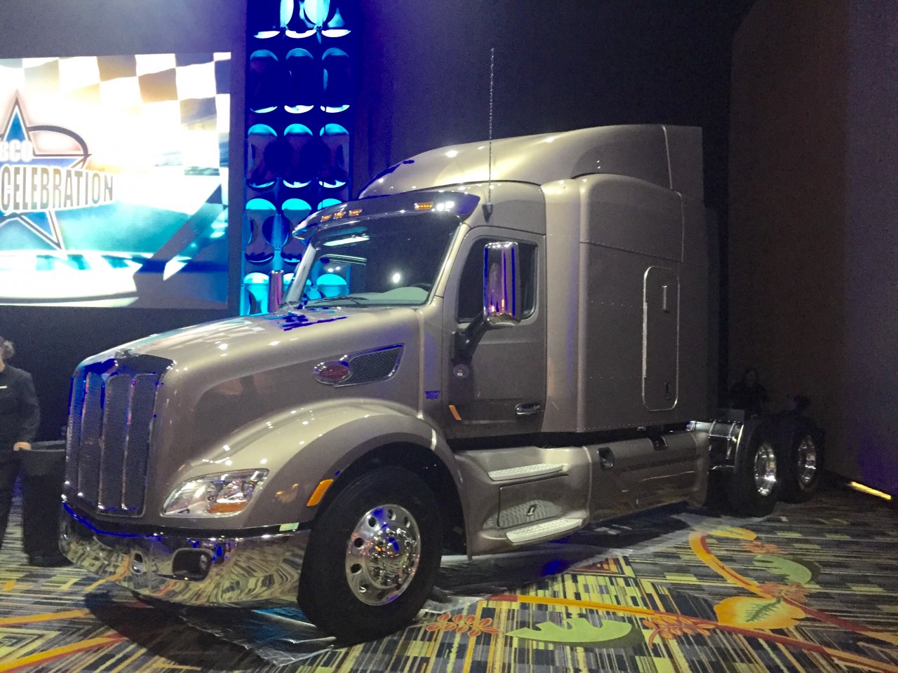

    I hope the winner realizes they need to come up with around $40,000 in taxes for their free gift at the end of the year.

    LS pays your tax, if you keep the truck for one year.

    You wouldn't have much use for that, it don't have a sink/shower/ or potty in it. Besides it just wouldn't look right deadheading around the country in something that new.

    I don't have to worry about it, I am not in the final 5.
