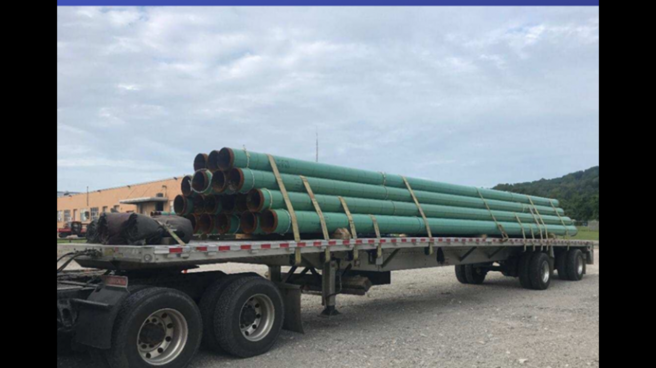

    Little over my head , but does this securement look ok? Saw it on the web.......

    He’s good for 40’ pipes. I probably would have put one or two more over the top.

    Ya, I thought the middle over everything looked a little light.....

    I would of belly wrapped front middle and rear
