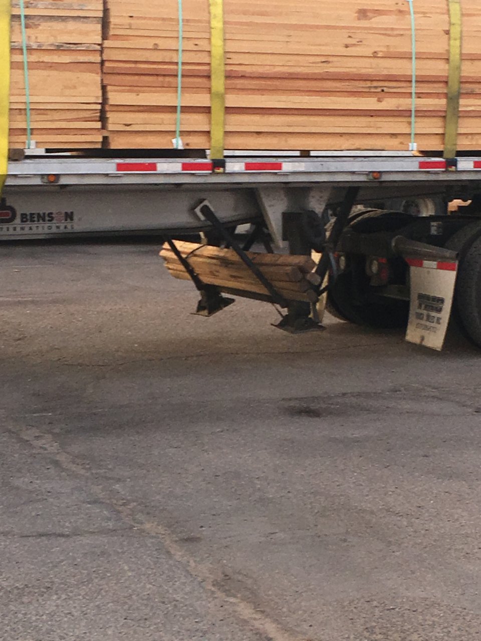

  8. stwik
    11,756
    166,919
    Spot what’s wrong
    TMC edition dos
    OLDSKOOLERnWV Thanks this.
  9. Espressolane
    17,597
    107,947
    Not sure what you think is wrong. The photo is small and not so good as to see the big picture you do.
    I do like the bungees on that bowed up dunnage on the dolly brace.
  10. Gumper
    Gumper Road Train Member
    1,579
    3,843
    Jan 7, 2018
    Butte, MT
    Looks like the jack is bent?
  11. Dave_in_AZ
    57,155
    390,530
    The far landing gear isn't perpendicular. Don't know if it's just the foot is stuck, or the whole thing is bent.
