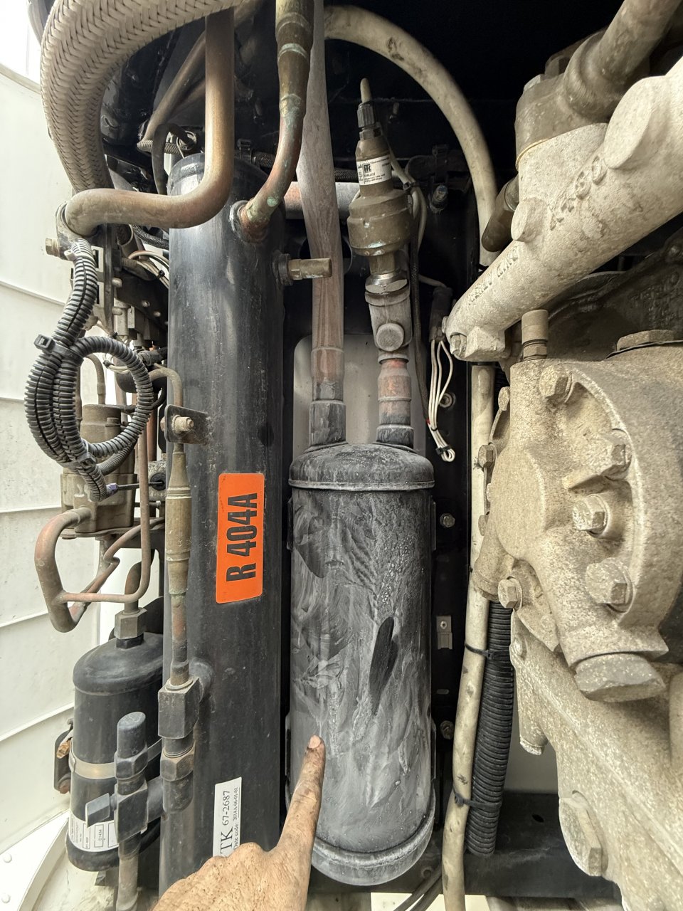

    Also your unit will go into low idle to maintain temperature whwn it reaches thw set point in start and stop, and will go to low idle when it gets within a degree or two when in continuous.

    Run it +5 -10 continuous, probably what the cold place has theirs set at any way, see if it holds that on low idle. Then bump it to 0
    what year is the trailer? 6+ years old with hot product on 90* days will be sure to keep it screaming

    Whats mean temp spread? How can i find that on menu? I set it at -10

    Ok i will set it to +5 continuous and will wait until its hold on +5 then will set to 0

    Ok i know where is that tray i will do that when empty and will let you know.I really so appreciate that man!!

    In the meantime, I would get a piece of wire and try sticking it in the drain hoses and see if you can get some water to drain out.

    It’s pretty good idea!i’ll do that
